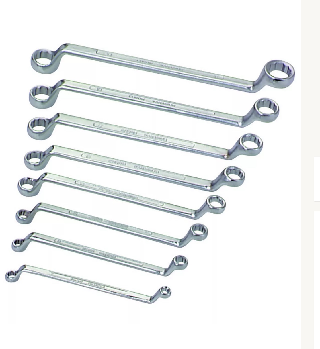

I just cut slots out of the subframe flange that get`s in the way of accessing the bolt heads. Then you need a closed end wrench with O degree offset and thin like these wrench`s. I just happen to have. Expensive if you don`t.

I just replaced both front A arms last year,for the two bolts that can not use ratchet to loose it, I used the Offset Box End Wrench ( pictured ) to loose it without jack the engine up,a little tight space be patient and it works...Hope this helps.
