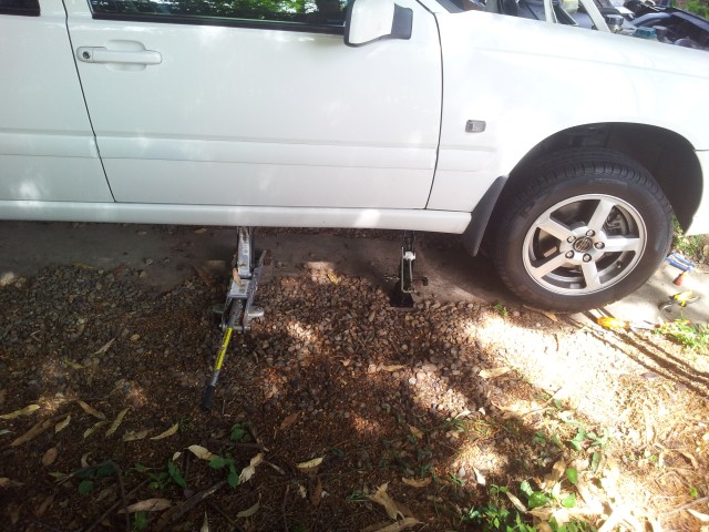

Another happy new forum member here, did this shim fix this morning and has fixed my issue, saved me $$$. My 2000 s70 air con would work for 5-10 min then start blowing warm air. If the air was turned off for 5min then it work work again as above. I did not measure the gap with a feeler gauge and just took a punt after much reading on the issue. I just used a few beer can clips cut to size as below, nice and easy.
jack car up on driver side

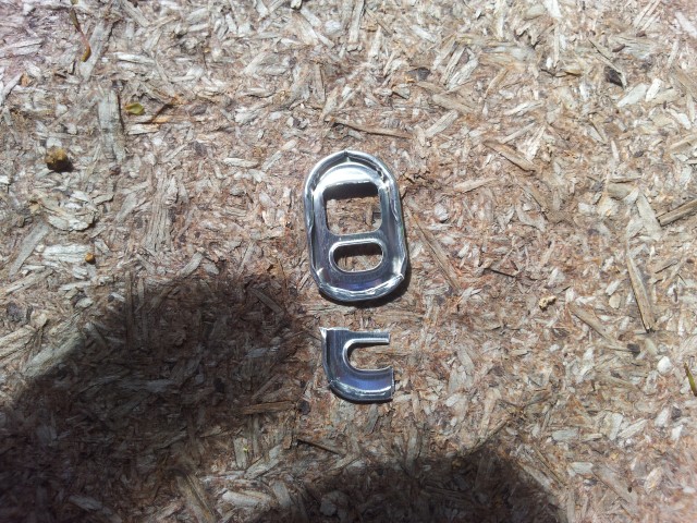

cut piece from can clip
20140111_084204 (Small).jpg (168.72 KiB) Viewed 4115 times
insert as shown ( 3 places )
I use some long nose pliers to get the clip started after levering the clutch down with a screwdriver, then just pushed it all the way in with the other screwdriver, also dropped a little super glue on top of each but this probably didn't need to be done.
