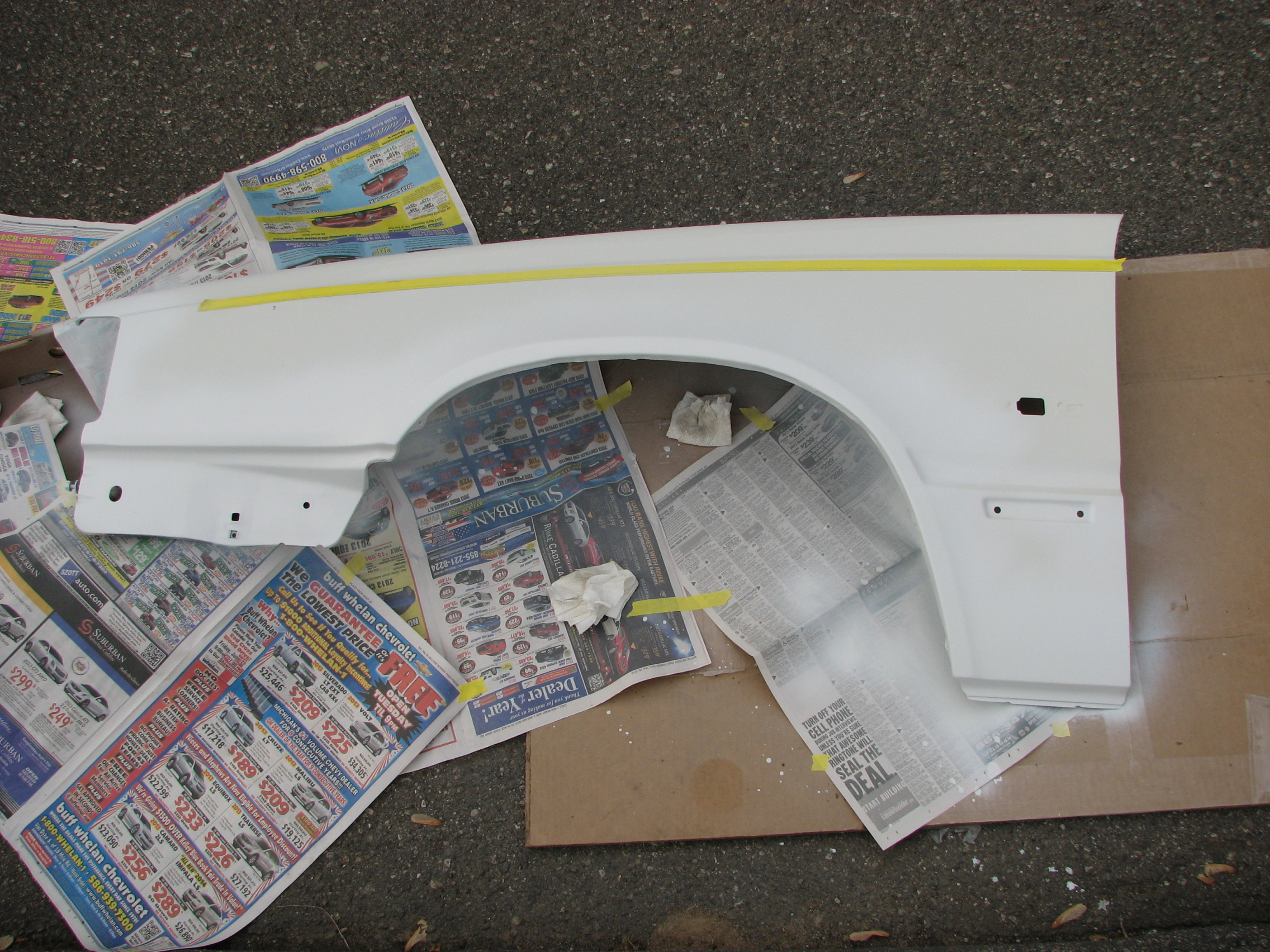

Also prepped right front fender since they are off. Currently painting left fender after sanding some surface rust around the inside lip.
Left fender primed.
Left fender primed.
Right fender rubbed out.
Emblem with 3M molding tape.
Right fender done.
Right fender done.
I need to finish the left fender and paint the bumper cover. The rest of the wagon is in great shape.

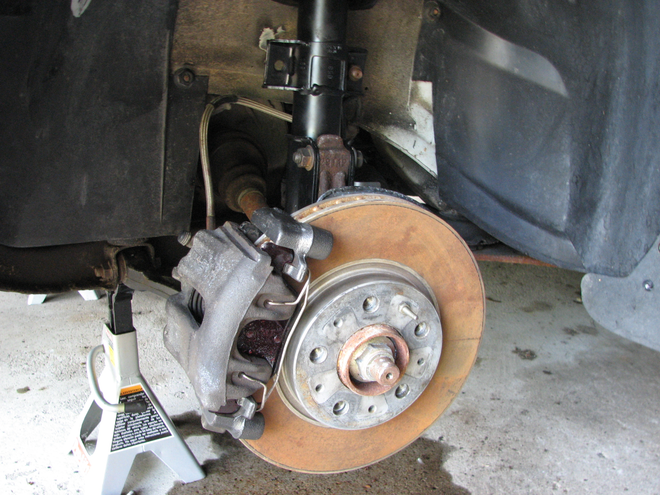

I had some new-in-the-box, Sachs struts and IPD HD spring seats that were intended for the Sedan, but the wagon was in need of the whole shot.
I had an assembly line of parts going on.
New Sachs Super Touring with IPD HD seats.
All buttoned up and ready for a test drive.
I meant to add, I swapped out this non-heated, non-powered seat from the wagon. The tear in the bottom is the only thing bad. I replaced it with the heated non-powered seat from the Sedan, which came from a '96. For the sedan, I installed a heated, powered passengers seat from a '98 XC70 ($50.). I also had to use the seat belt.
This was useful as a very comfortable work chair to do strut surgery.
Under a shade tree in a comfortable seat, on a hot day.
I was very happy to find coated rotors in this condition, with only oxidation where the pads make contact. $10. a side for everything with pads in new condition, no wear at all.
The test drive made the Sedan jealous for giving up its struts. It feels smooth and quiet.
