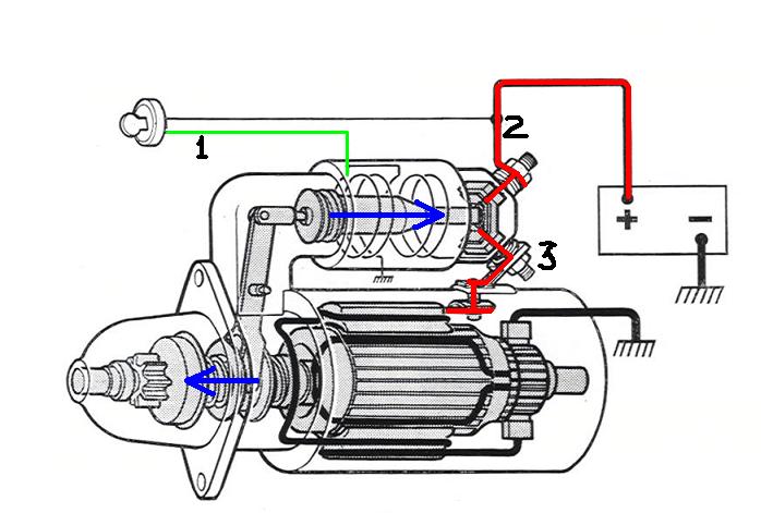

This is strictly for academic discussion.....the normal process is:
1. Crank the starter, current flows to GREEN wire, activating the Solenoid.
2. The Solenoid is moved (BLUE arrows), and 2 things happen simutaneously:
- engaging the clutch to flywheel
- sending power to the motor (RED arrow current flows from "2" to "3")
* Even with the 1st photo posted by the original poster... The BROWN Cable (which I assume is ground) is a mystery. I have never seen the big Brown cable in the vicinity of the starter motor.
* Now if the BROWN Cable was attached to the inboard post, why didn't he see sparks flying when he cranked the starter?
