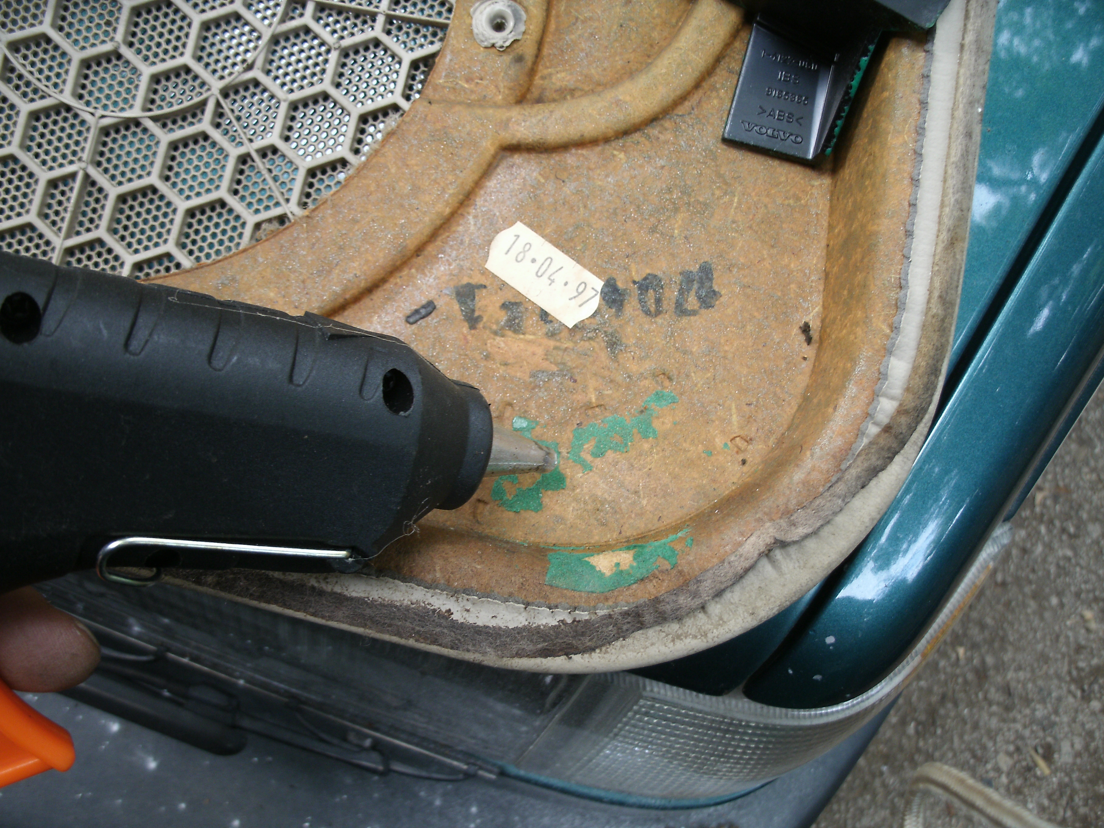

As Robert noted, the door panel mounting clips, even when using a proper panel removal tool, are guaranteed to break in one form or another. Volvo's “green” initiative has resulted in adhesives that don't stick and plastics that disintegrate. I guess they feel good about themselves but it really sucks when you try to remove the panel. There is a very good chance that some of the panel clips themselves will break and it is a good idea to pick up some replacements from a dealer before you even start. The part number is 9182897 and they retail for $2.15 each but you can get them a bit cheaper through the websites. I have tried to find some more generic panel clips at the local auto parts stores but I have not found any that fit correctly. If I am working on the doors I pick up at least a dozen which will usually be enough to replace the clips that clips that break on four doors.
The plastic mounts for the clips are an even bigger problem but they are actually fairly easy to fix. A hot glue gun will re-attach the mounts quickly and they seem to hold up well enough to get the panel back on and it will stay on at least until you try to remove it again. The outline of where the mounting clips were attached to the panel have residual, green colored (how quaint), adhesive on the panel itself and you just need to line the clip back up to that outline when you glue it back on.
As you can see in the pictures above, the environmentally friendly foam will have disintegrated and it will just rattle in the new speakers if you leave it there. The foam gets gooey if you press it so it is best removed with a shop vac to just suck it out of the back of the speaker grill.

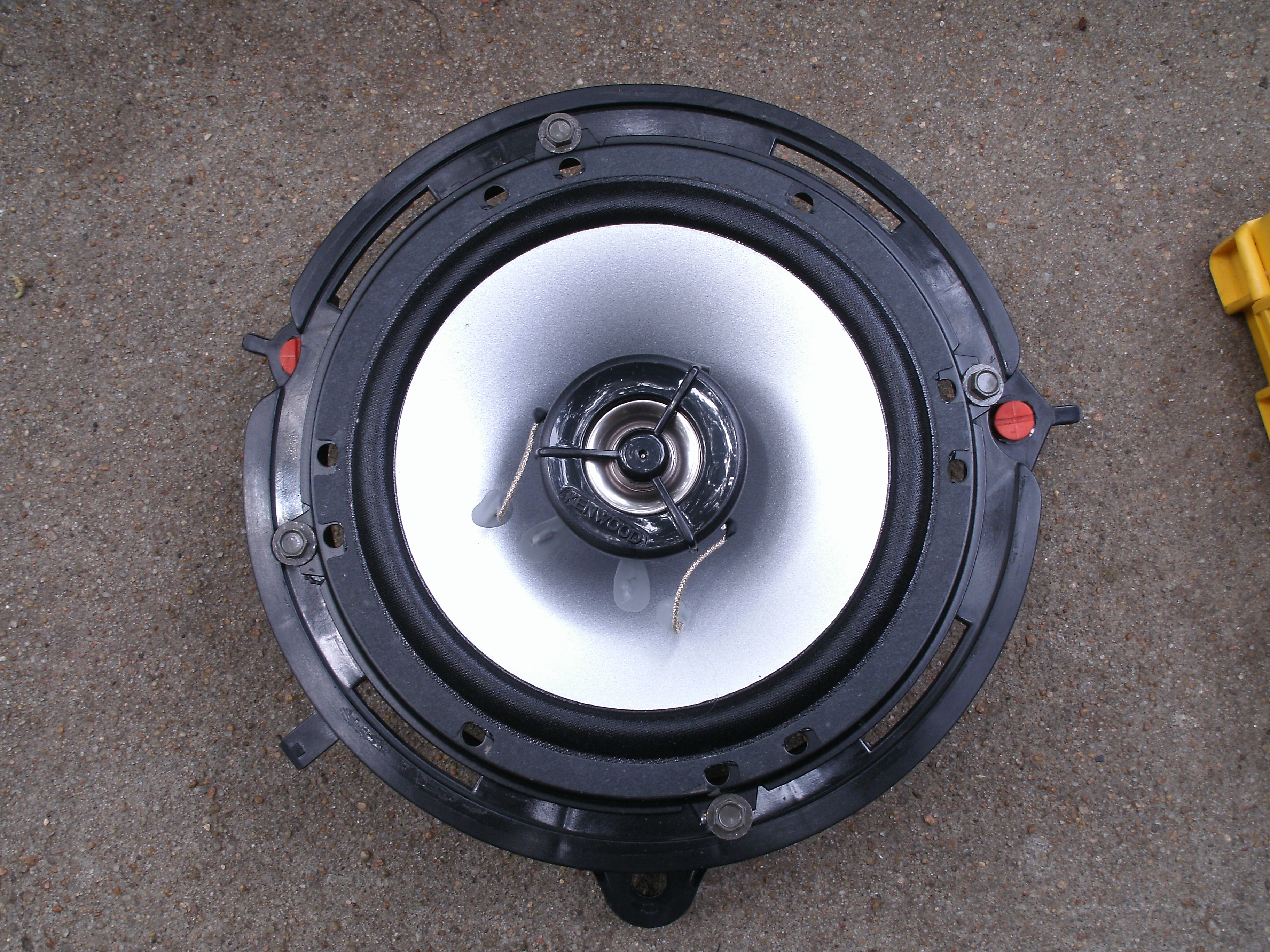

After removing the panel from the front door which is done with, more or less, the same methods used on the rear panel you can remove the speaker from the door. In order to remove the front door panel you will also need to remove the cover trim plate for the wires to the mirror. Those mounts are very fragile and extra caution needs to be used when removing the cover plate. The speaker is removed by twisting the red locking pins 90 degrees and then using a pair of piers to remove the entire pin. The bottom of the speaker frame is secured with a single T-25 torx head screw.
Volvo departed from the glue and screws method of securing the speaker to the frames on the front speakers and wen with a twist tab and adhesive design. To remove the speaker from the frame just break the twist tabs off with a pair of pliers and then pry the speaker out of the frame.
The connectors on the front speakers are part of the old speaker itself and it can't be reused like they were on the rear speakers.
The tab mounting method also leaves no factory holes to mount the new speakers with. I used some short self drilling screws to secure the new speakers to the frame.
For wiring I matched the wire colors for phasing and used solder and heat shrink to splice the new speaker wires with the factory wires. Other options are crimp style butt splices or tap style insulation displacement splices.
From here it is a matter of re-installing the speaker frame with the new speaker and door panel. The front door panels usually require more repair than the rear panels since the panel wants to split away from the trash / junk bins and it takes more glue. Make double sure that you have all of the connectors, including the trunk / fuel door switch and the mirror switches, plugged back in before snapping the panel back in place. The speaker itself is secured to the door by pressing the red push pins back into the holes and installing the Torx screw.
