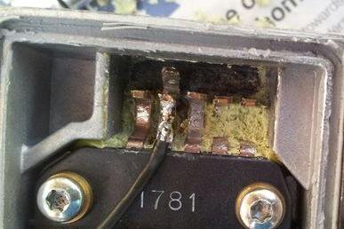

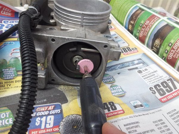

ImageTake a look at these pics I made of procedure.
Always measure the voltage at the replacement sensor BEFORE removing the sensor. When testing the voltage just use a clamp to keep the new sensor on then remove it quickly to adjust the magnet rotation.
With your unit check that the throttle flap isn't binding as the magnet can stick on the armature in the other end of the casing to the sensor you replace. If it's binding and you are certain the bore is clean you may have to grind all 5 pins down on the opposite side and remove the bulb end to expose the armature wires then grind them off the posts.
After that remove throttle flap and remove burrs from throttle shaft with dremmel as the screws on the throttle shaft are stamped on their ends to prevent their loss. After doing this slide out magnet and check the aluminium sheathing for evidence of chafing to the armature. If it has been chafing you can remove 0.25mm from each side of the oval shaped ends.

Sacer's flimsy instructions are attached as a PDF, not that they really help at all.
Some more pics
SA300 customer assembly information sheet(1).pdf
(424.12 KiB) Downloaded 1275 times
20120406_124136 %28Large%29.jpg (135.19 KiB) Viewed 7683 times
20120406_150554 %28Large%292.JPG (105.63 KiB) Viewed 7683 times
