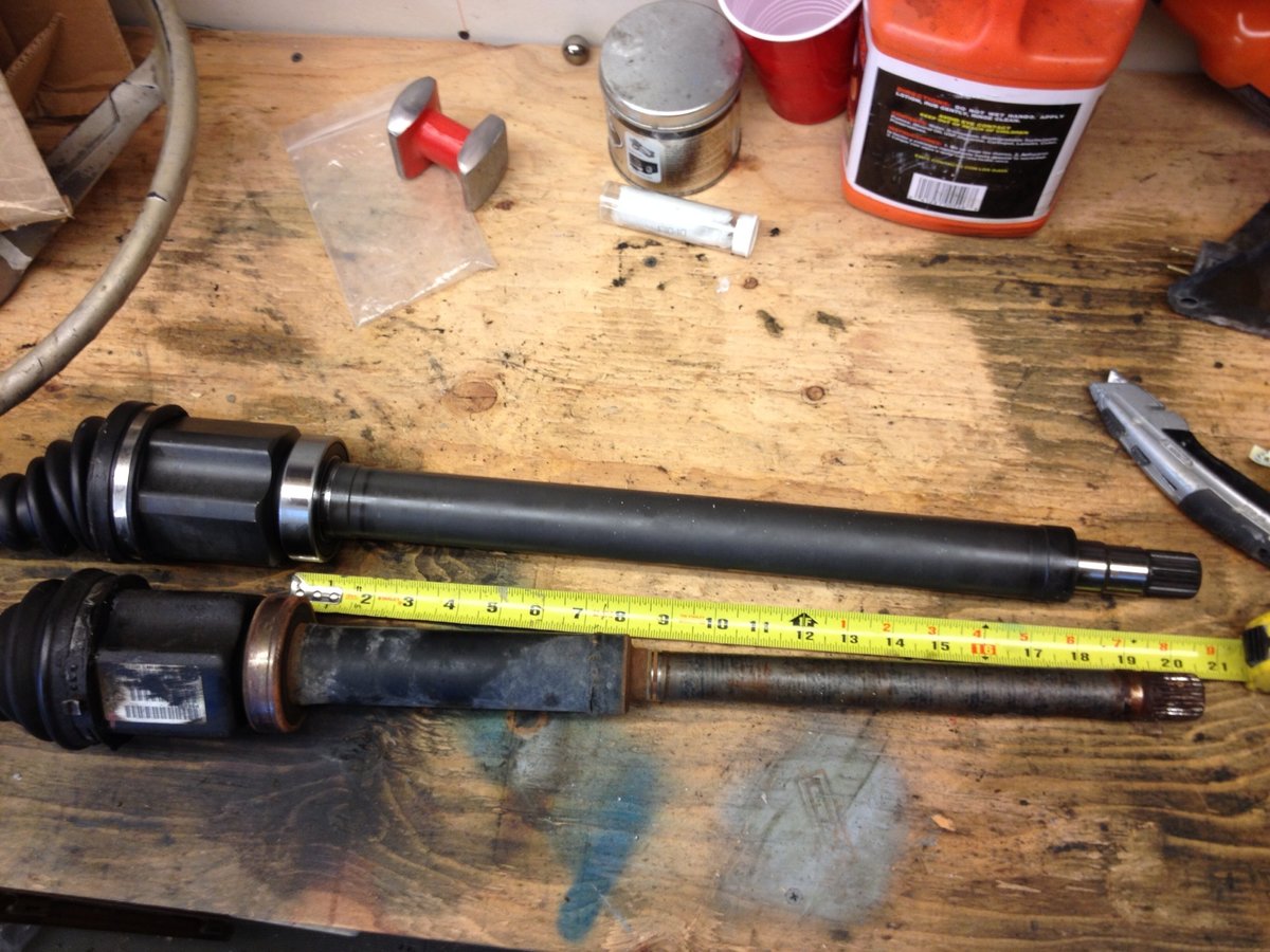

I ordered a new passenger side cv shaft for my
04 v70r. My shaft is different from the replacement.
Any thoughts,
Glenn

front wheel drive vs all wheel drive

Who'd you get it from?
This comes up regularly. Some catalog system has R's miscategorized.
