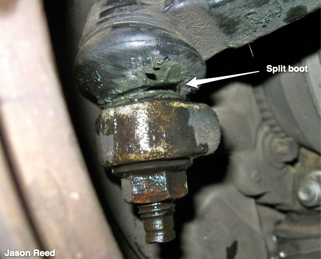

The bellows on the outer tie rod end on the driver’s side was split. Grease was leaking out. It would not be long before this joint would be dry and corroded. Then it would loosen up and start squeaking.

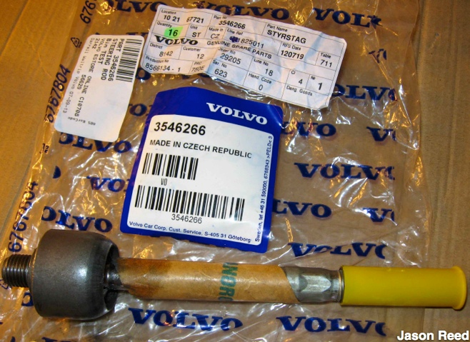

Inner tie rod ends, part 3546266. (Two needed, same part for left and right sides). These came with “NO ROST” rust preventative paper wrapped around the shafts and had balljoints that were pre-greased.

In the photo below you can see some deep cracking in the rubber bellows at the ball joint on outer tie rod. This tie rod end was on the passenger’s side.

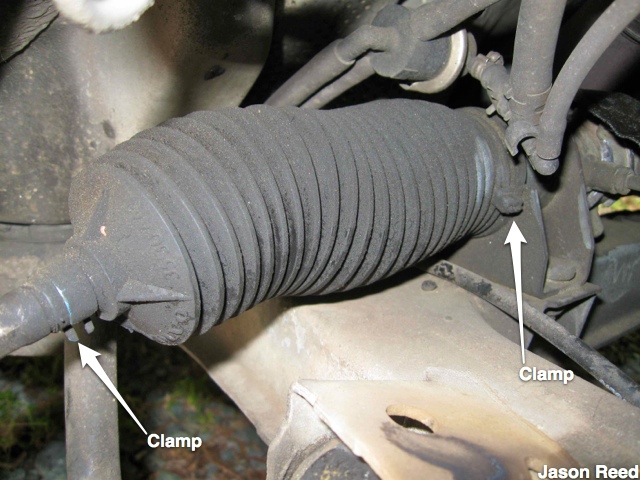

The photo below shows the inner tie rod end covered with the bellows. A metal clamp at the small end and plastic clamp at the back end near the rack hold the boot in place.

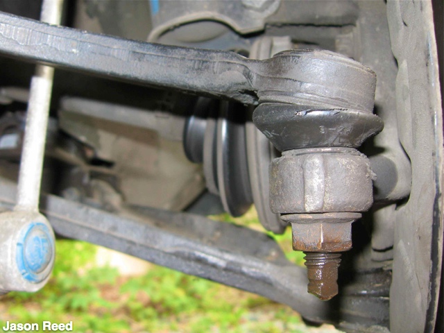

Step 2: Loosen 18mm nut on ball joint. I used a 6 pt deep ½” drive socket.
Once the nut it loose, remove it if you are not going to reuse the outer tie rod. If you are going to use it again, then I would leave the nut on to cover the exposed threads during the next step when you whack the steering arm with a hammer to make the tapered part of the ball joint pop out.

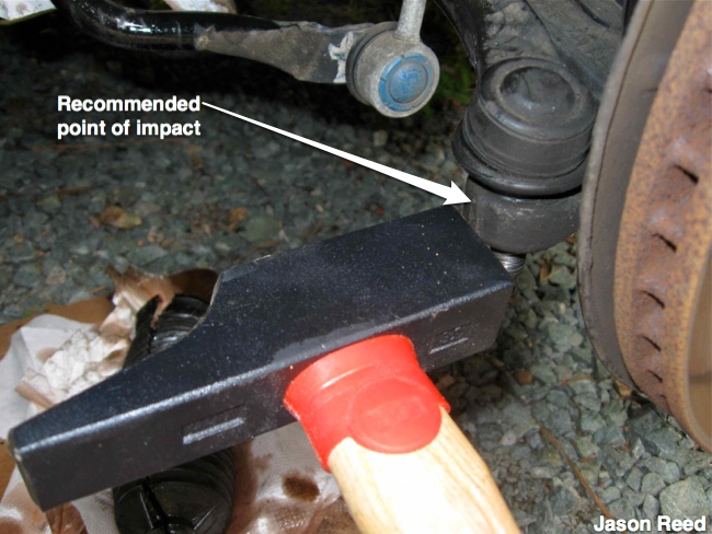

Step 3: Strike steering arm.
I tried whacking the steering arm with a flat faced hammer (shown above) but after about a dozen whacks there was no movement of the tapered balljoint. I decided that more blows and heavier blows were needed, but I was concerned that I might hit the brake shield or brake rotor and cause unintended damage.
So I used two hammers, one ball peen hammer placed on the steering arm and a second hammer to strike the back of ball peen and transfer the blow. This was a tip I picked up from watching a video called “Steering Concerns” by Dan Reed (no relation) from the Community College of Philadelphia in which he replaces inner and outer tie rod ends on another type of car. I watched this video a couple of times—it’s great!
http://www.ccp.edu/site/about/ccptv/car ... cerns.html
When it pops loose, you will see a gap.
Withdraw tie rod end from steering arm.
Next, you turn to the boot covering the inner tie rod. Clip the plastic clamp at the back of the bellows. These clamps are similar to tie wraps but seemed to be designed to lock at the correct position rather than be adjustable.
Be prepared for ATF to pour out of boot (if the steering rack seals are weak or failing). Put a catch pan underneath just in case. I was a little surprised to see how much ATF had leaked into the boot, especially on the passenger’s side. The driver’s side had less fluid, but there was some. I may have to have the rack rebuilt or the seals replaced at some point.
Remove clamp on front of boot.

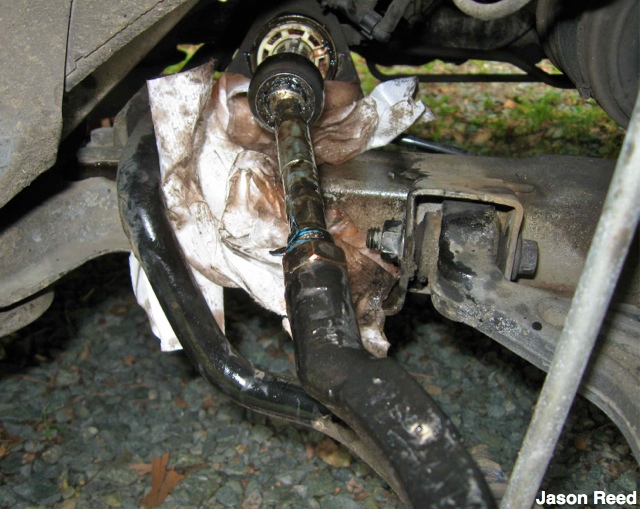

View of exposed inner and out tie rods, ready for inner tie rod end disconnection.

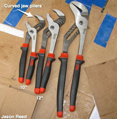

Picture of useful pliers for removing inner tie rod end:
I really like this set of pliers pictured above that I got at Harbor Freight. I only needed the 10” and 12” sizes to remove and install the inner tie rod ends, but it’s great to have the 16-inch “commander” (at the far right) available in case it’s needed. You could use other tools such as a pipe wrench or perhaps a special inner tie rod end removal tool if your inner tie rod end has flats to grip, but these 10” and 12” pliers were all I needed. They worked well for me.
To loosen the inner tie rod, counterhold the very end of the steering rack (not the shiny machined surface of the main steering shaft) with one plier (the 10” worked well for this) while twisting the inner tie rod end off with the 12” plier.
Once you break the threads loose on the inner tie rod end, you may be able to spin it off all the way by hand. On the passenger’s side it was a bit sticky and I had to use the 12” pliers a time or two to fully unscrew it. I kept the 10” pliers in place to keep the rack from twisting.

Next, I compared the old parts with the new to make sure that I had the right stuff. The new parts had the same shape and size as the originals.

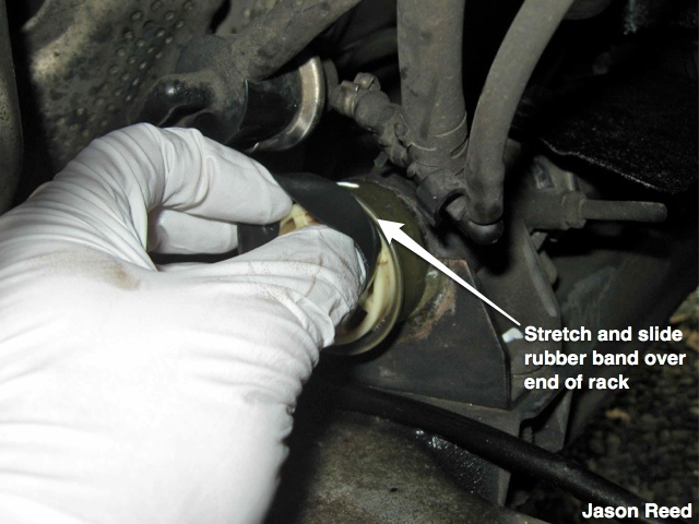

To begin the installation of the new parts, first I stretched the new black rubber band over the rack. I put a little silicone grease on it first and then rolled it over the edge and onto the mating surface.

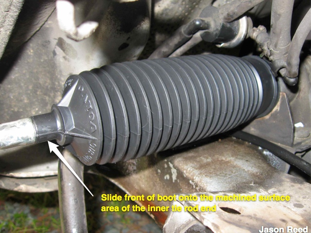

Next it is time to install the new boot over the inner tie rod end. Remove the rust-preventative paper and the yellow plastic cap if you haven’t already. I applied a little silicone grease to the mating lip inside the end of the boot. Partly this was because I had studied Nlemerise’s write-up of how difficult it had been to install the boot and I wanted to make it easier to slide it over the rack. In the end, the boot installed easily and quickly with no problems. When I re-examined Nlemerise’s write-up afterwards, I realized that the boot used was probably not OEM – it looked shorter and had fewer pleats than the OEM part. I think this is why he reported having so much trouble getting the new boot onto the end of the rack. So, I’d recommend getting the OEM boot kit to help make the job go smooth and easy.
With the boot in position on the rack, slide the front of the boot over the smooth machined surface on the inner tie rod end as shown:

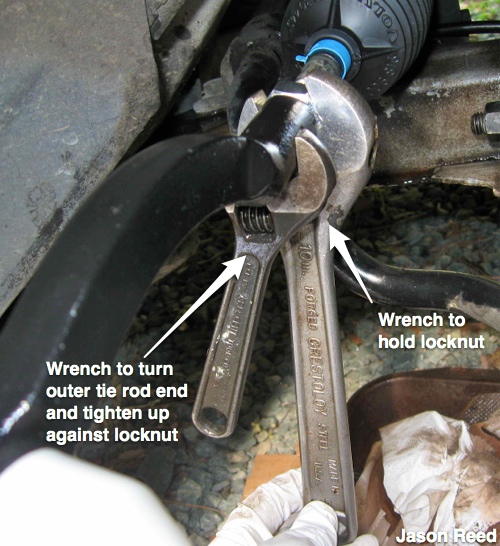

Then, thread the new outer tie rod end onto the inner tie rod end until you reach the lock nut. Don’t allow the locknut to turn.

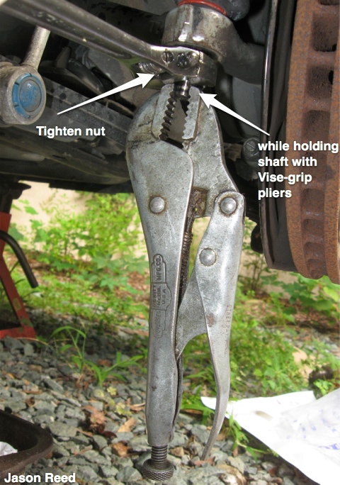

Next, I used a couple of adjustable wrenches. The bigger one is to hold the lock nut in place – don’t turn it because it is controlling the length of the tie rod assembly. The smaller one in the front is used to hold the flats on the outer tie rod end and tighten it up against the lock nut. Don’t worry that the ball joint on the outer tie rod end is not pointing in the right direction at this stage to fit back into the steering arm – you will rotate the whole tie rod end in the next step to aim it.
Then, remove the white plastic protective cap if you haven’t already.
Insert the balljoint into the steering arm and begin tightening the nut.
You may find that the balljoint will tend to spin while you try to tighten the nut. I used a pair of vise grip pliers to hold the shaft of the balljoint:
Volvo recommends 70 N-m / 52 ft-lbs torque for tightening the tie rod nut.
Once the balljoint has settled into its taper in the steering arm, it won’t spin as you apply the final tightening torque.
