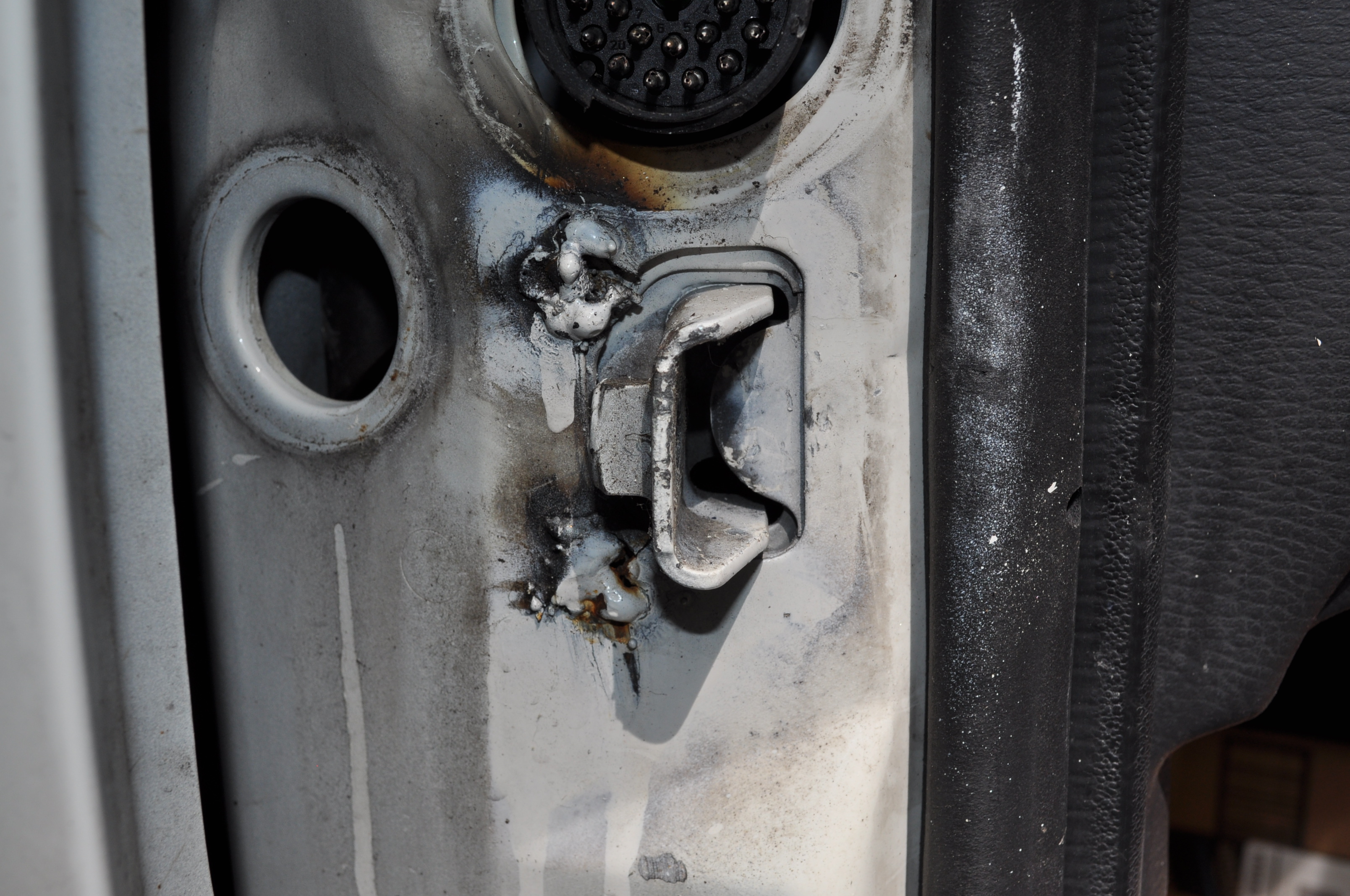

Shortly after I got my V70 last summer the driver side front door check failed. It had been repaired before, but the work didn't last. It took me a little while, but last weekend all stars were aligned just right, and I went to work.
Thanks to this site, I had great infos on how to take the door panel off, and also on how to take the door itself off on just the pins (this was super easy!)
A while ago, I bought a flux core MIG welder, which came in handy for this job. The bracket on the A-pillar needed to be re-welded, and the door needed a patch panel welded on.
Door taken off, Old Repair on A-pillar
At one point, the bad door check bracket must have been neglegted for quite some time, because the upper mounting point in the door was literally ripped out. A flat bar was used to mount a new door check:

Next was cleaning off all the old welds. I did this mostly with my Harbour Freight version of a Dremel tool and grinding discs, which worked well. Also, to prep for welding, I needed to pull the bracket back close to the pillar. For this I stuck a threaded rod which I had laying around thru the hinge holes, and twisted a wire thru the nut in the bracket and the rod and then put tension on it:
A-Pillar cleaned

Because there is so much force on that little bracket on the A-pillar from the door check spring, I was trying to come up with an idea to reinforce that area. There is enough room to weld small gussets on top and bottom of that bracket, and that's what I decided to do. This creates much more welding area, and it catches some of the force better:
Welded Bracket with Gussets
I know my welds aren't very pretty looking, but I know they penetrated enough. I'm new to flux core welding, having welded only with shielding gas before. And it works quite different. But I was also very paranoid about not generating too much heat or the hot wire maybe poking through, because I was so worried about something on the other side catching fire.

I think the actual design flaw is on the other side of the sheet metal on the A-pillar. The fact that Volvo engineers decided to stick a bracket thru an opening and weld it from the back side was not that great IMO. Because now you have tensile force on those welds at all times when the door is closed, and when the door is opened and closed.
I can't think of any other car manufacturer that did it this way, nor do other fail like this.
