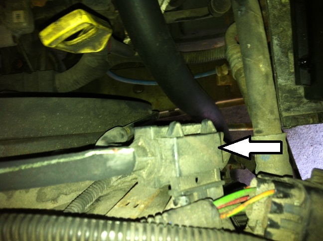

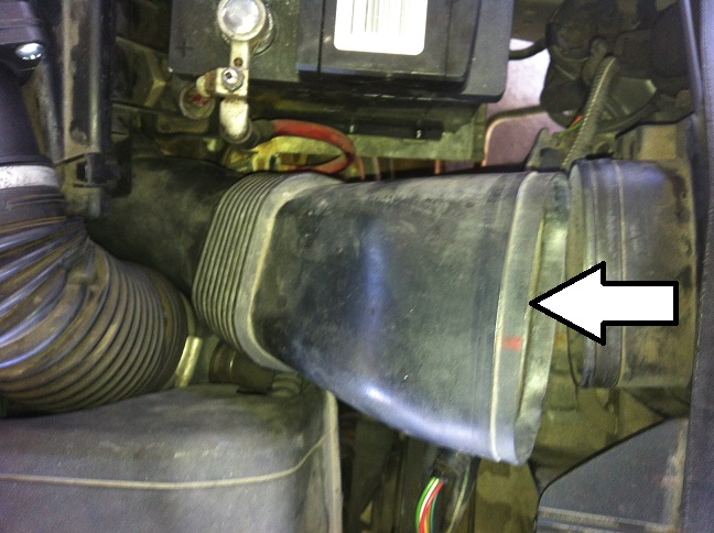

I have p0455 code and I need to replace the evap purge valve and I read where it should be located but need help identifying it. I added pictures with arrows pointing to parts I need help identifying. Also, in car2.jpg, what is that vacuum hose's function?

- Is this the evap purge valve?
- car.JPG (112.34 KiB) Viewed 624 times
- car1.JPG (100.31 KiB) Viewed 624 times
- What does this hose do?
- car2.JPG (113.83 KiB) Viewed 624 times

Purge valve is picture #2.
#1 is just the air intake snorkel for the engine. It connects to a duct at the top of the radiator to make a factory cold air intake.
#3 is a fan plug or something.
