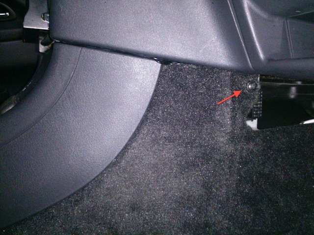

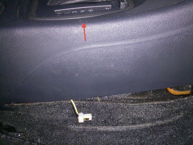

Just replaced mine and took some pictures, hope it helps other members.
My car is 1999 V40 2.0 (RHD so light bulb is located on right side)
Loosen the only screw, and pull and slide the panel out.
The bulb holder is located underneath the 'N' position, slip your fingers inside the console and pull it out.

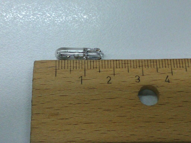

I don't know the part number but this is how the bulb looks and its size. I wrapped the bulb with tissue paper and pull it out with a plier.

just replaced this shifter indicator bulb and the cigarette lighter perimeter light in a 2003 volvo s40. the bulb used for both was the 2721 or 2721LL available at oreilys auto part stores (usa) $5usd for 2 incandescent bulbs. the socket type is t5. the fit and length was a perfect match to oem.
