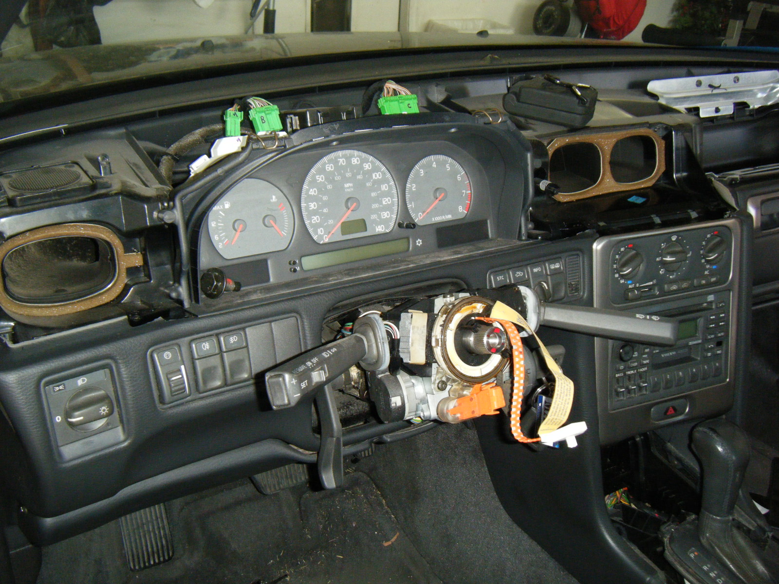

Steering wheel, soon to be removed
S70 DASH REMOVAL_and_REPAIR-2013_0724-112258.jpg (114.79 KiB) Viewed 4381 times
Screw in place to keep the spool from unwinding...
S70 DASH REMOVAL_and_REPAIR-2013_0724-114546.jpg (116.19 KiB) Viewed 4381 times
The screw used here was the one originally (if you look at the previous photos) screwed through the tail of the yellow "tape" keeping it secured inside the steering wheel assembly
S70 DASH REMOVAL_and_REPAIR-2013_0724-114558.jpg (110.53 KiB) Viewed 4381 times
Here we go...
Here we go...
S70 DASH REMOVAL_and_REPAIR-2013_0724-115426.jpg (113.61 KiB) Viewed 4381 times
18mm socket required to remove the large steering wheel bolt...
S70 DASH REMOVAL_and_REPAIR-2013_0724-115448.jpg (97.84 KiB) Viewed 4381 times
It's out...that's got to be factory red "thread locker" on there, as I don't believe it's ever been removed...
S70 DASH REMOVAL_and_REPAIR-2013_0724-115540.jpg (109.49 KiB) Viewed 4381 times
I marked the position in a couple of locations...again, to aid aid during re-assembly...
S70 DASH REMOVAL_and_REPAIR-2013_0724-115720.jpg (211.58 KiB) Viewed 4381 times
And...it's...
And...it's...
S70 DASH REMOVAL_and_REPAIR-2013_0724-115822.jpg (115.57 KiB) Viewed 4381 times
...out!
...out!
I also marked the signal and wiper stalks for ease of thought during re-assembly...
S70 DASH REMOVAL_and_REPAIR-2013_0724-120830.jpg (115.65 KiB) Viewed 4381 times
Left stalk removed...
S70 DASH REMOVAL_and_REPAIR-2013_0724-121126.jpg (121.89 KiB) Viewed 4381 times
Right stalk removed...
S70 DASH REMOVAL_and_REPAIR-2013_0724-121518.jpg (117.26 KiB) Viewed 4381 times
