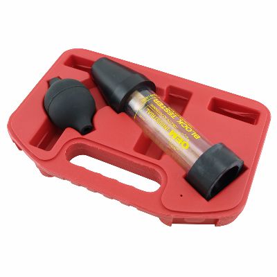

The "Block Tester" is really handy and as said you can get it as a loaner tool from most parts stores.
Stop leak is something an owner uses or chooses instead of the correct repair but shouldn't be any mechanics fix for a problem. If you were give a quote and balked at it, being presented with a stop leak as a very temporary solution to the problem is understandable as long as it was clear it might not work at all and if it did it was temporary. No mechanic should use stop leak to band aid a car unless it's the owners choice to do so.
IMHO Any customer is better of with a leaking car sitting at a shop where the customer is safe and warm rather than having it open up in a day, week, month ... and be in traffic and or far away from home.
How to on the block tester:

Step 2...I did the block test (looks for exhaust gases in the coolant). It passed.
Step 3...At this point I really don't think i have any options but to pull the head all over again, and have the head presssure tested and checked for flatness.
