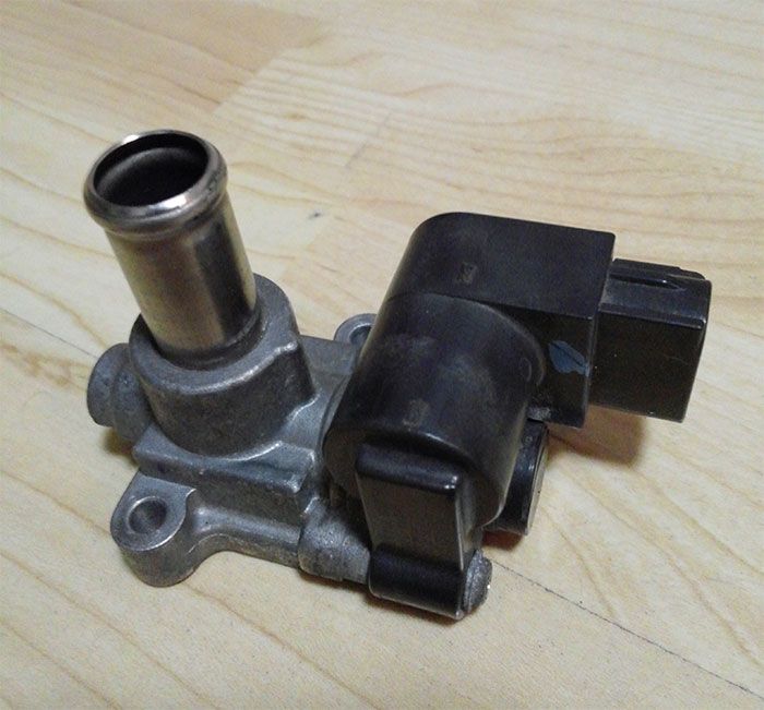

Do you have a picture of the valve you replaced?

Indeed, I have a picture of the valve that I replaced:
