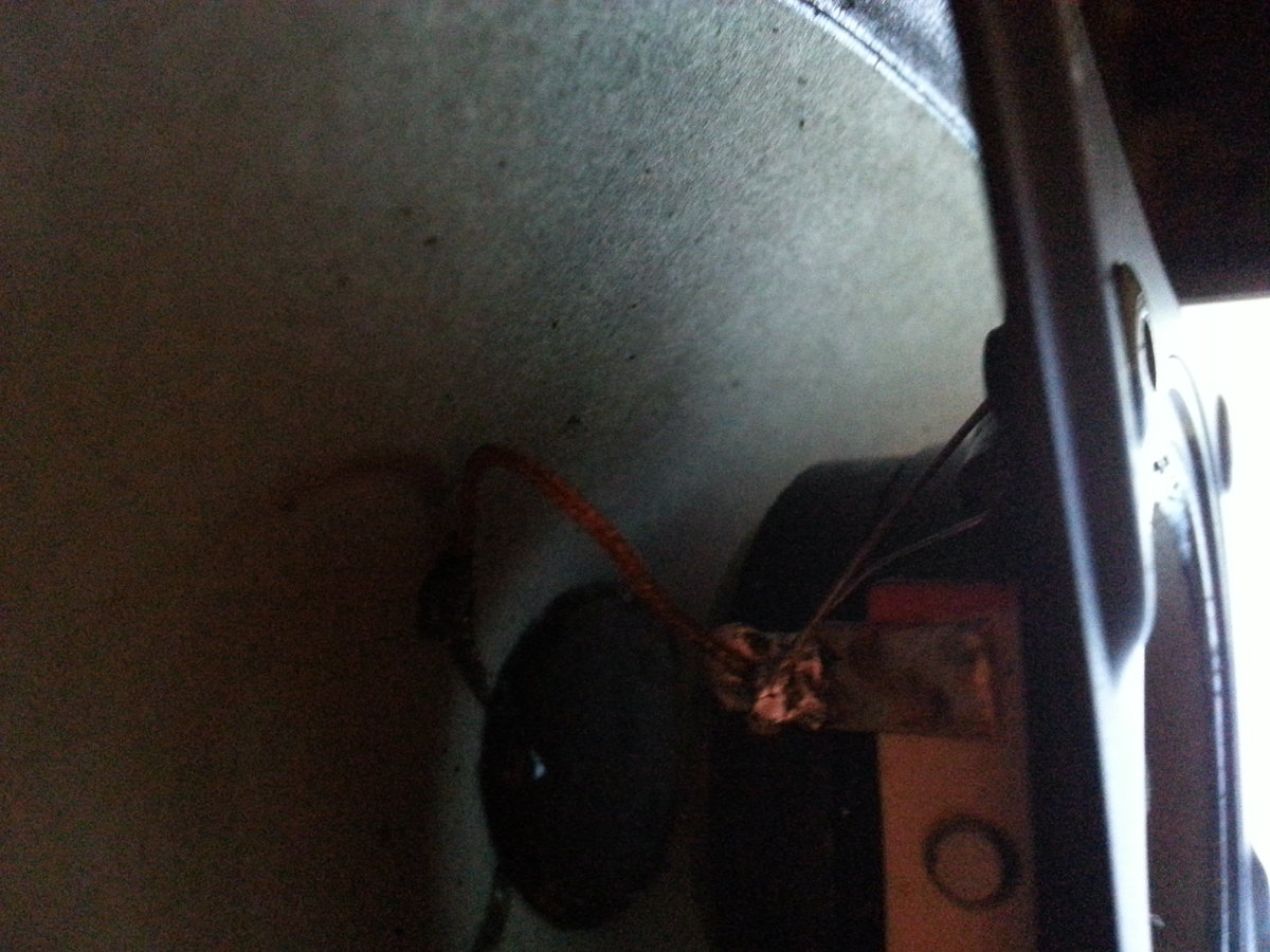

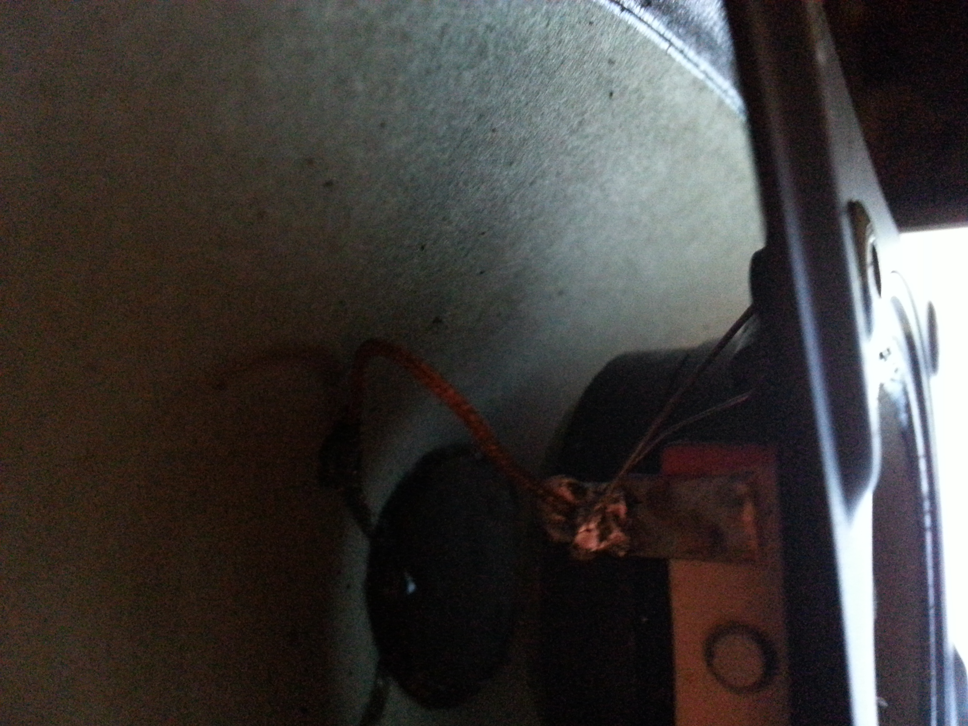

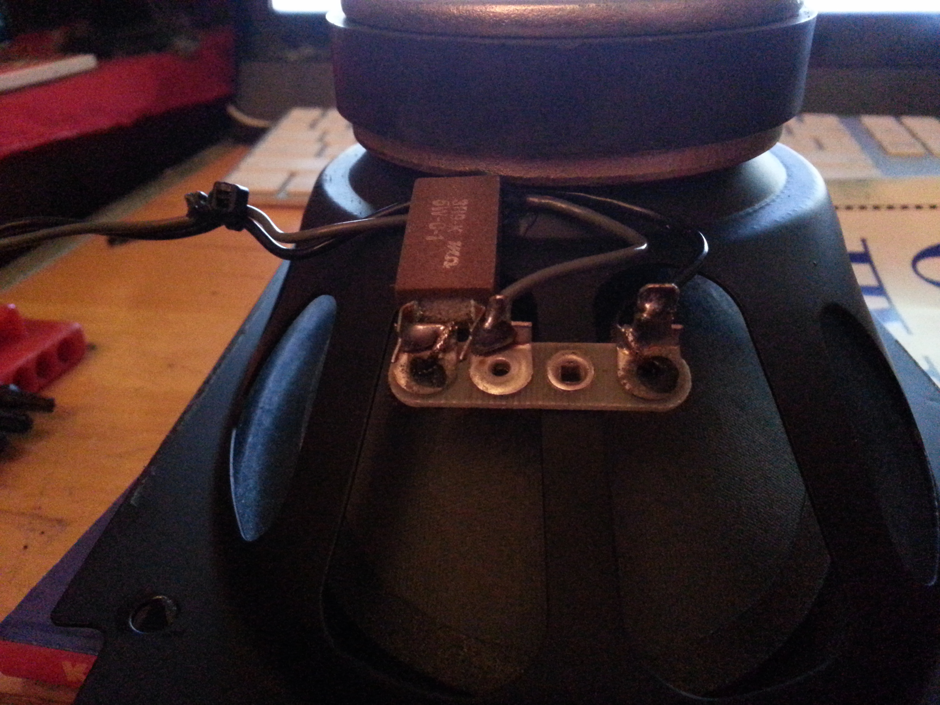

This is the part I am not sure about. Maybe it went bad?
Thats the part I had to solder
