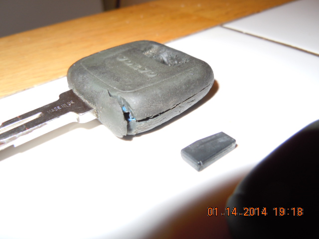

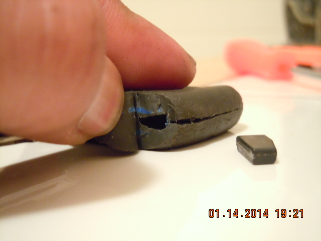

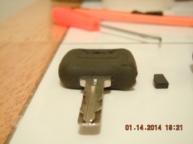

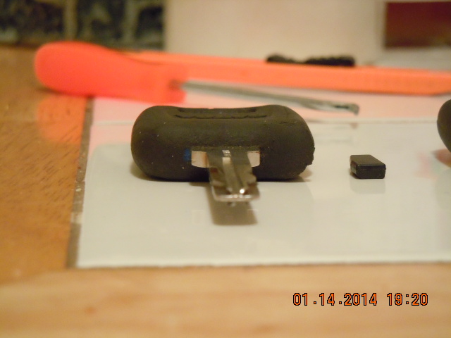

That was almost 3 years ago. Ever since I have read up on all the Volvo forums trying to find a viable solution. I always liked the remedy where you remove the chip from a working key and tape/crazy glue it near or inside the immobilizer ring. After that just cut away on any key you can find and it should work even though I've been told that a unprogrammed chip will interfere with this mod so you have to remove the unprogrammed chip from the key. Here are pictures on how to do this. I have 2 keys as I mentioned before. One with a programmed chip and the other without or malfunctioned chip which the dealer couldn't program. I removed both chips. 1st the defective chip key on which I cut a little too close to the chip and took off a corner but fortunately that DIDN'T matter and I did it correctly on the programmed key. I think earlier Volvo's have a glass capsule with the chip in it but mine had these squarish chips in it. They come out easily. Just make sure you cut into the side where the blue dot isn't located. After cutting down the side of key towards the key blade you cut sideways widening the area to loosen the plastic around the chip and chip will just slide out by itself. This chip is more robust than the glass capsule version so a few hard cuts won't damage it. Please study pictures carefully especially the cut going down. If you feel resistance DON"T force it. Reposition and try again. Good luck !

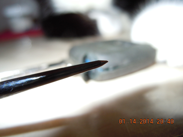

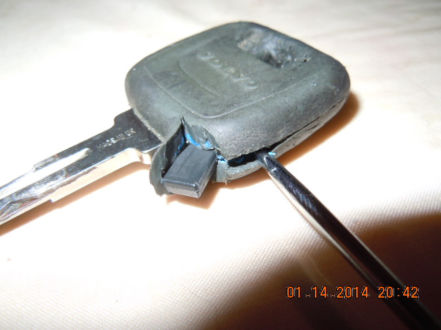

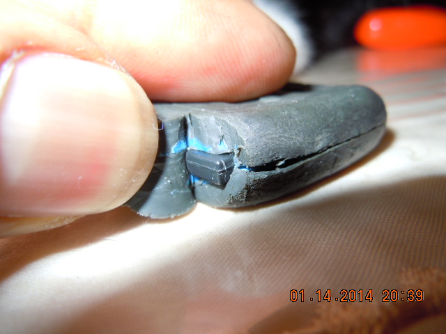

Once front of chip is exposed you make a cut above halfway down the side of key. This cut is more like scoring the gray soft area until you hit the chip itself which you will feel so do the scoring with moderate pressure because you're trying to widen the area to release the chip. After every 2 scores with "moderate" pressure you try to wedge a needle or screwdriver to widen the area as well and shortly the chip will move out by itself. Once it does just pull it out and you're done.

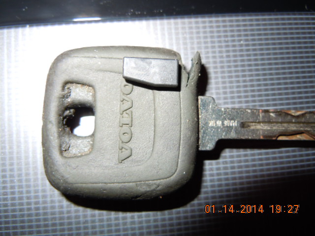

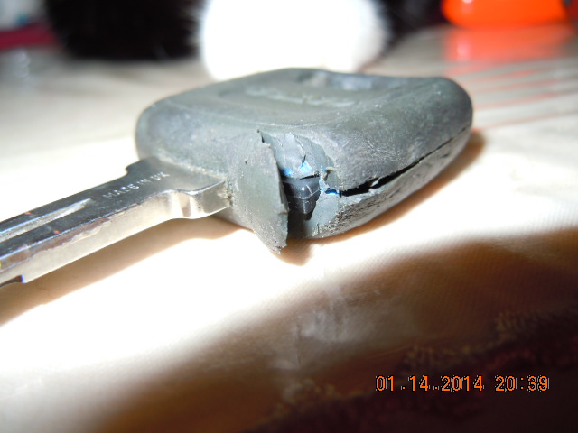

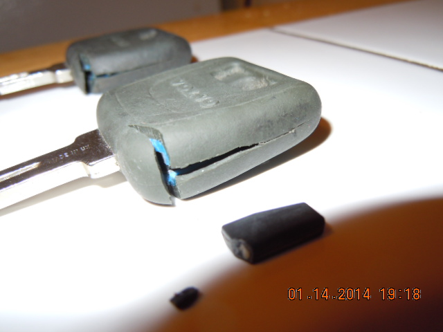

Here I cut too close to the chip and thought that I had hit the blue hard plastic and applied more force with the box-cutter. BIG MISTAKE ! Lucky for me and all of you this was a malfunctioning chip that was meant to be sacrificed. Next time I cut a tad bit away from the problem area slowly feeling for any resistance. That turned out perfect below.
Ohh, hello there sexy !

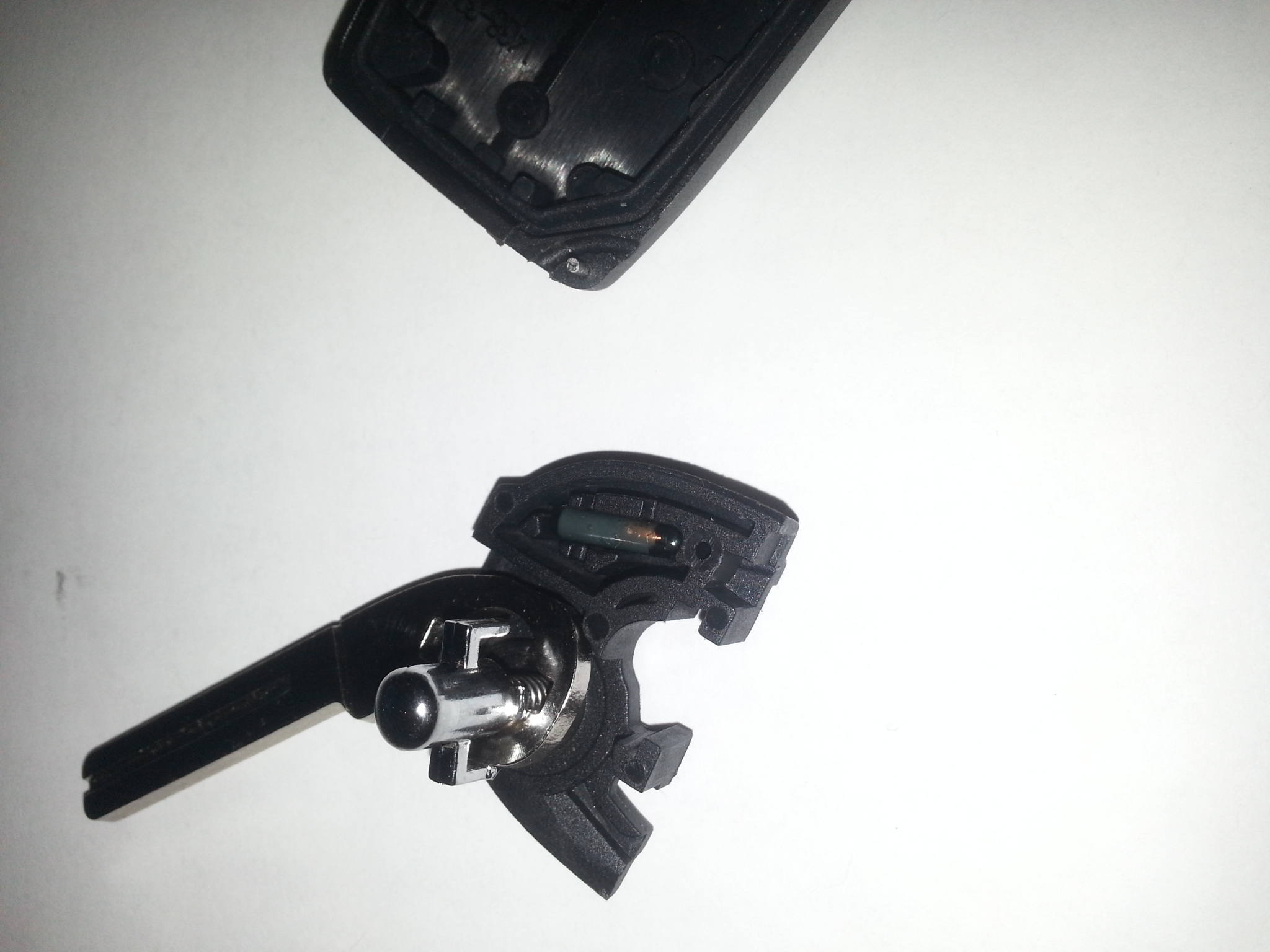

For afew dollars I ordered a flip key conversion kit to suit early P2s. This is how it went:
Cutting the glass encased chip required gentle angled cuts so the blade stayed well away from the glass. The earth strap looks a little loose on the battery however with some tensioning should be OK. I like the idea of having something more modern looking and the flip design keeps the blade away from wear and tear in the pocket.
Next step is to find out the key code from the dealer and get the new blade cut.
The glass encased chip fitted in the replacement casing
