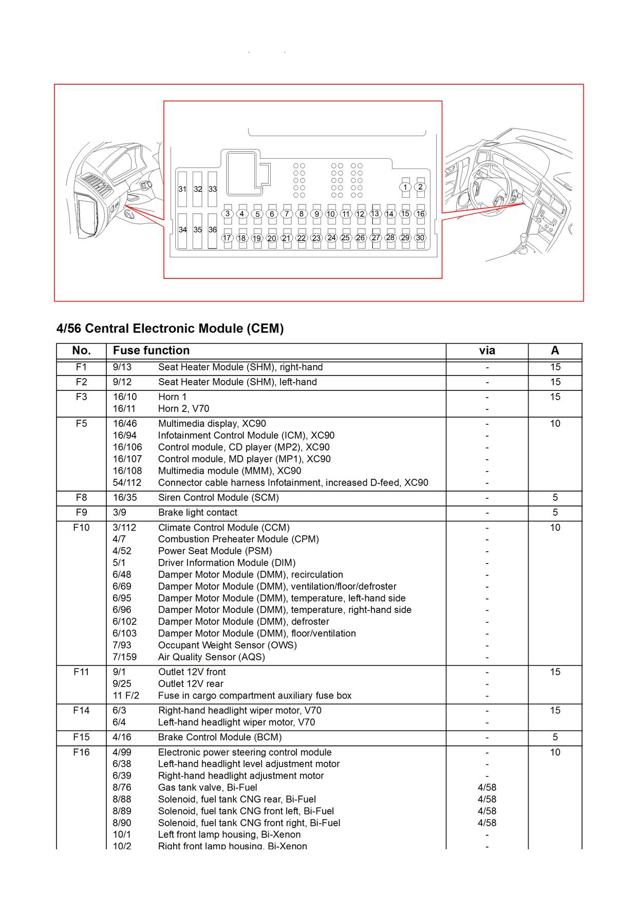

It is fuse F8 of the CEM under the steering wheel.

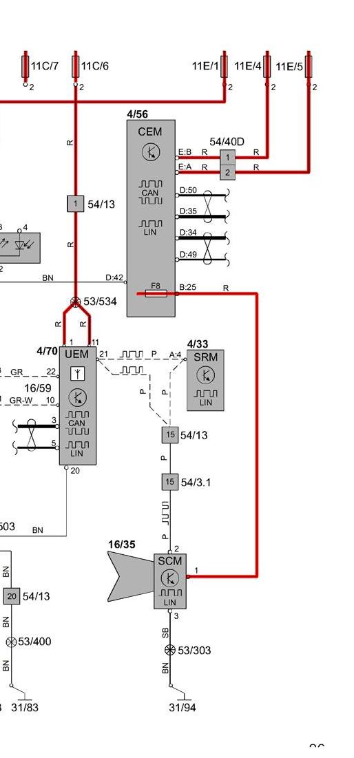

The information display may indicate an alarm system malfunction with the fuse removed. If the alarm module isn't replaced the other best alternative is to disable/remove the alarm system as JRL said.
