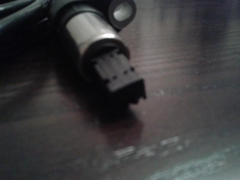

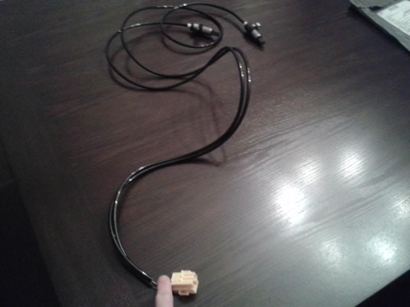

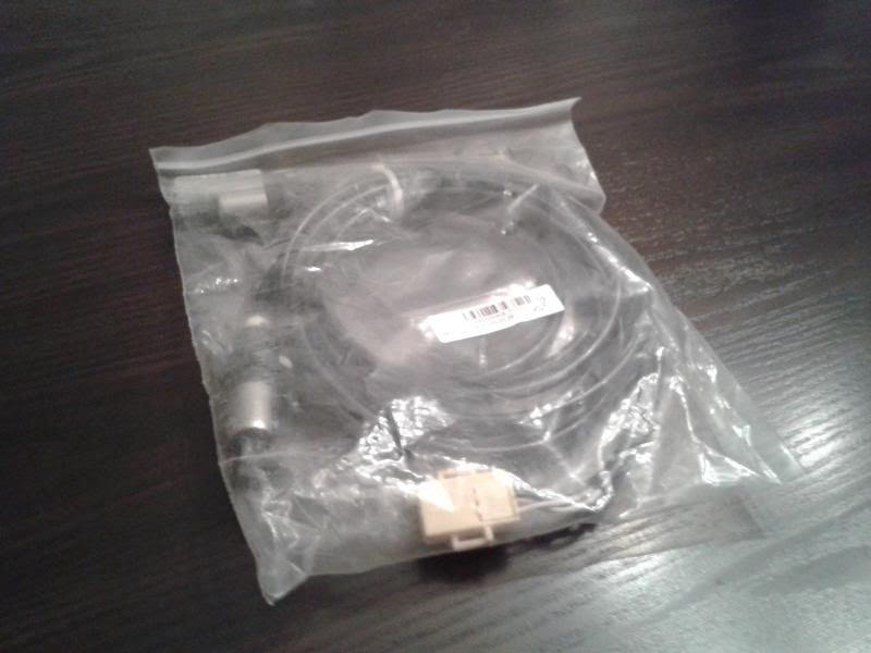

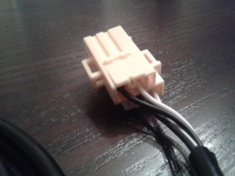

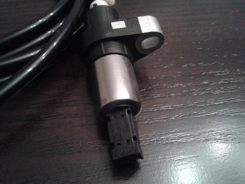

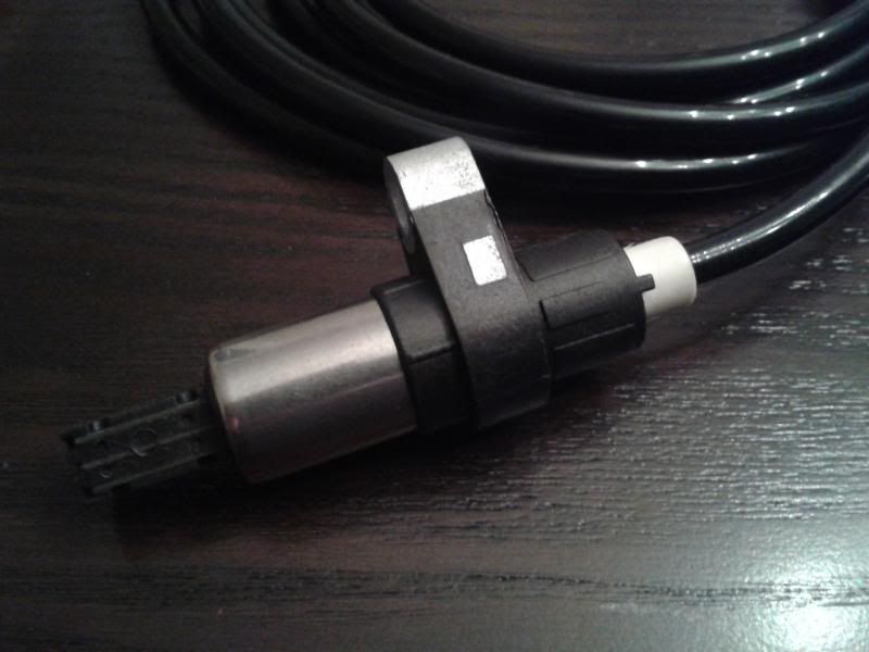

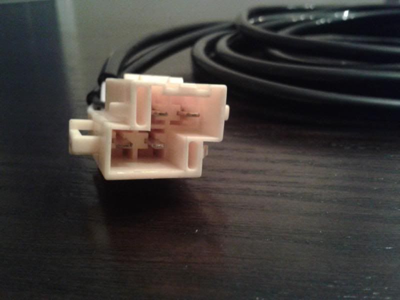

So here's what my $20 bought:
No box-I guess to save shipping costs!
Looks OK so far.

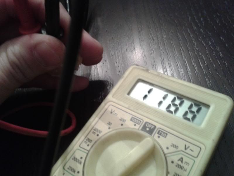

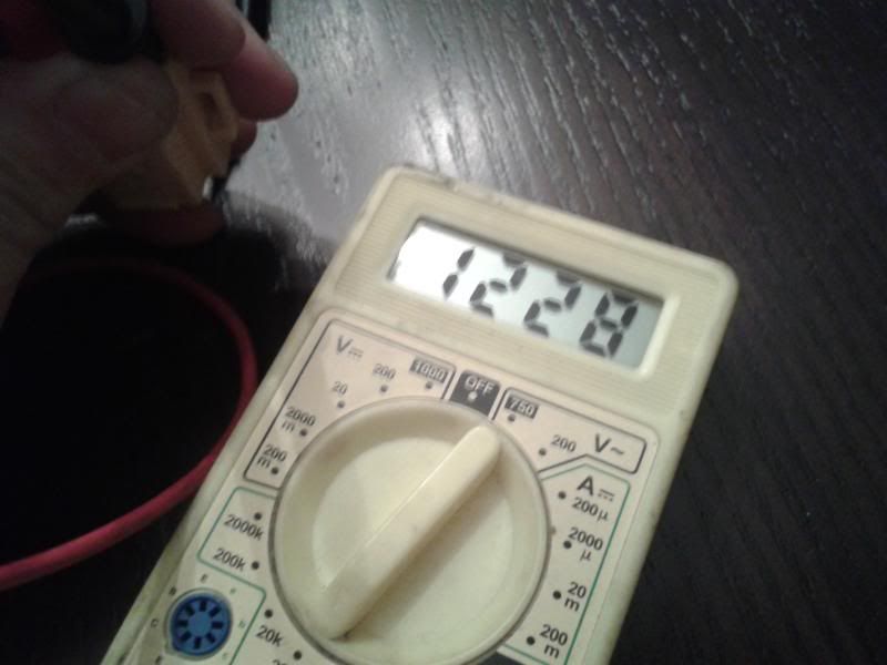

Resistance checks out as well.
As far as fitment is concerned-no issues on the drivers side but the passenger side needed some caressing to fit. I has a bit if corrosion from the wrong sensor being in there so it isn't fair to blame the new sensor. Plug ends fit perfectly and they were plenty long enough to reach.
Been driving for a few months with absolutely no issues.
So if you are in need of ABS sensors don't be put off by the MIC e-Bay specials.
