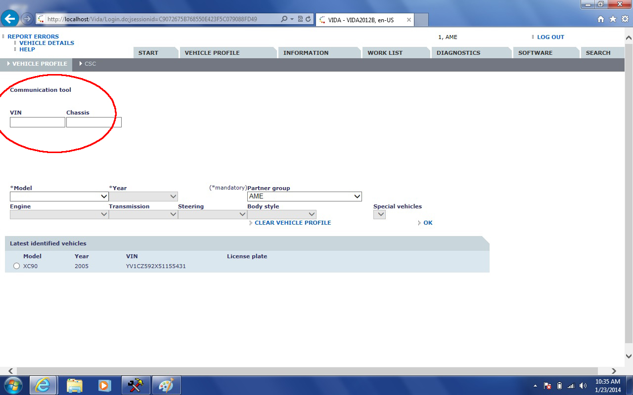

Trying to get VIDA on a new computer. Install completes without problems. When I load VIDA All in One and go to vehicle profile, there is no drop down box to select the DiCE unit (see attachment). There is also no where else that I can see of where to add the tool to VIDA (some instructions say its in a tab in 'perform computer settings' but its not there). When I load DiCE Diagnostic and connect to the unit that way, it connects fine and passes all communication tests.

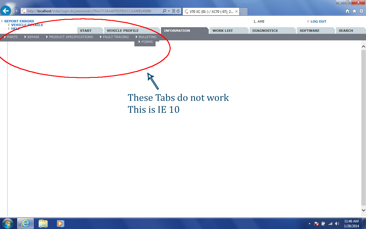

Thought VIDA was working fine after the downgrade, but it was just the next step to another problem. When going into VIDA, I was able to select the vehicle and go into the diagnostics and use that tab fine. The problem here is that almost the whole information tab is not working, causing each dropdown menu to not work and become more of text rather than a dropdown field. To fix that, I downgraded IE from 10 to 9 which fixed that error, but that caused the Communication Tool area to become a box with a red X in it. Downgrading it further to 8 did not work.
Summary of where I am at:
Both IE9 & 10 cause different issues (one fixes one but causes another), Framework at 4.0, Java up to date, no antivirus installed or activated, firewall deactivated, VIDA uninstalled/reinstalled.

Just a followup in case anyone runs into this problem. While VIDA calls for IE9, it ended up working on IE10 with compatibility mode turned on.

What is now the working spec of OS/IE system - memory, file format, disk size etc?
The pictures show you are using 2012B version of VIDA-DiCE.
