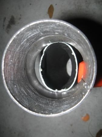

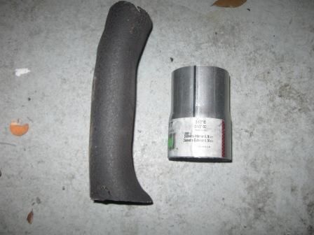

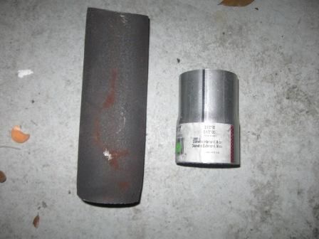

After installing a 2 1/2" Simons catback (of which the quality was outstanding) I did a post-mortem on the 20 year old factory exhaust on my 94 850 Turbo. I was amazed how flat the factory pipe was where it passed over the rear suspension. I have attached some comparison shots with a standard 2 1/2" ID/OD exhaust bushing next to the exhaust pipe that was the stock muffler outlet.
This is a inside picture of the stock pipe vs the 2 1/2" OD part of the bushing. It's one thing to know that the flow area increased, but it's another thing to see it.

Flattening should not reduce flow.
Tight bends that are not smoothly mandrel bent will hinder flow.

You are absolutely correct in that a reasonable amount of flattening is probably not the end of the world, but...it is always a reduction in cross-sectional area relative to a circle. That's geometry.
