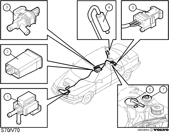

I looked for this evap canister and did not see it. Does anybody know exactly where it is on a 98 V70?

Check under the driver's side fender, you have to look up from underneath. The other location is back near the fuel filter, but that may be more common on an 850.
You can check the vacuum hoses in the engine bay for leaks by spraying them with starting fluid. If the idle surges, then the spray hit a vacuum leak. No substitute though for careful visual inspection.

The evap canister is a black box about the size of a Bible.

That's a nice diagram, note also the shape of the canister, will help you recognize it when you find it. The diagram shows the "near the fuel filter" option but don't give up if you don't find it there, check up front too.
