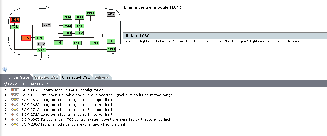

Hi all,
I have a few issues with my T6, but since this weekend the car just stalled. It had already difficulties with loss of power, but I never expected this. At first I though it was the Catalic Converter, but when I checked, I only had an error on the front LAMBDA sensor and non for the Cat itself.
The fuel trims are giving errors and the turbo charger.
I took it to the Volvo dealer, as I was a bit lost with all this and they claim it is the "Fresh air hose pipe" (part 8683125) that is broken and causes all the ECM errors.
Can anyone help me with this and explain why this would be? And why this would take then 2 hours to fix, while it takes me 10 minutes to remove and replace the part? Do I overlook something, or is the guy just taking advantage now.
I've attached the errors I have at the moment, including the Brake Booster, that is broken.
Many thanks guys.
