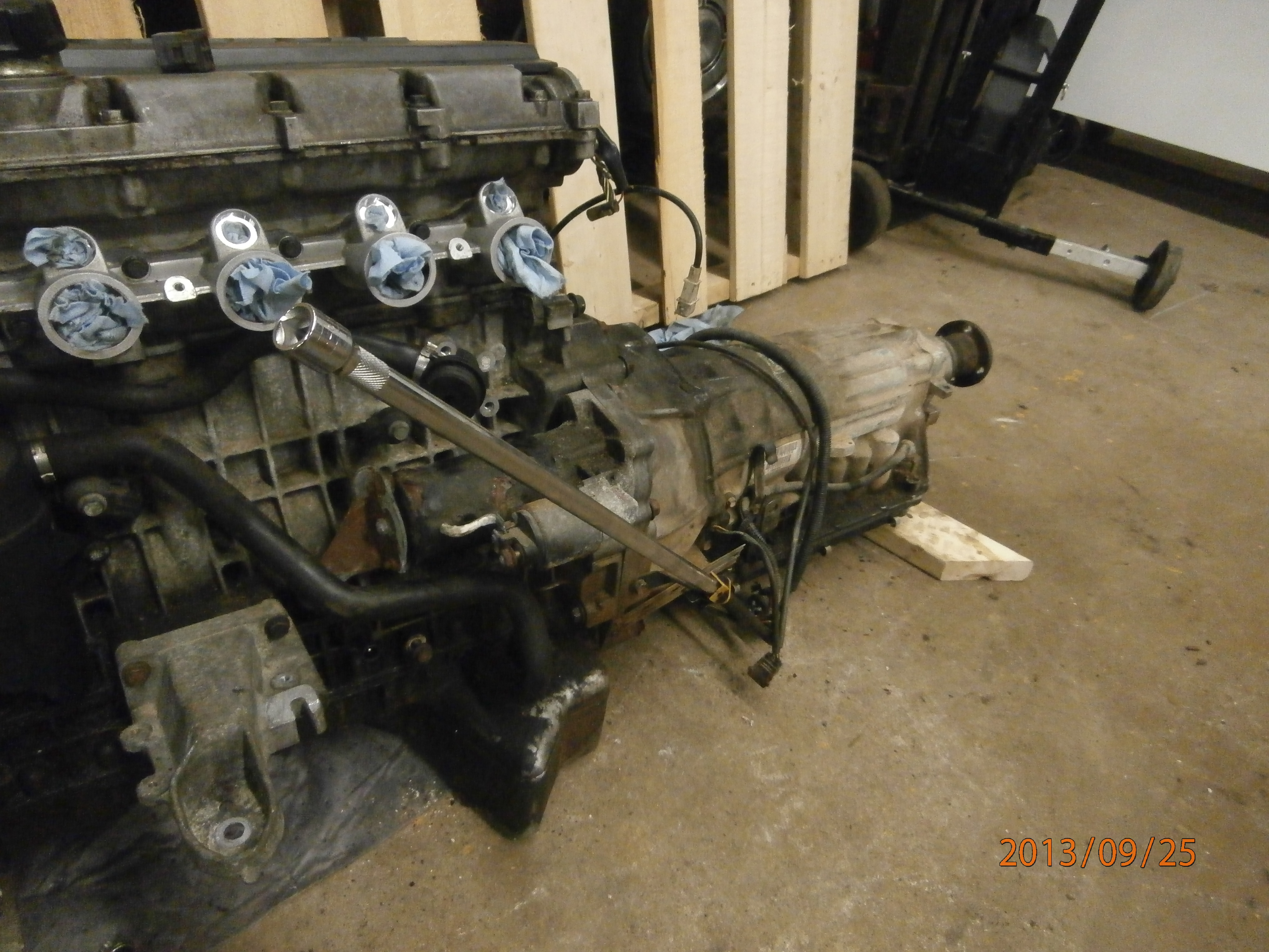

Use a 1/2 inch socket extension inserted inside the square. This is what the dipstick was designed for; the longer the better :grin:
