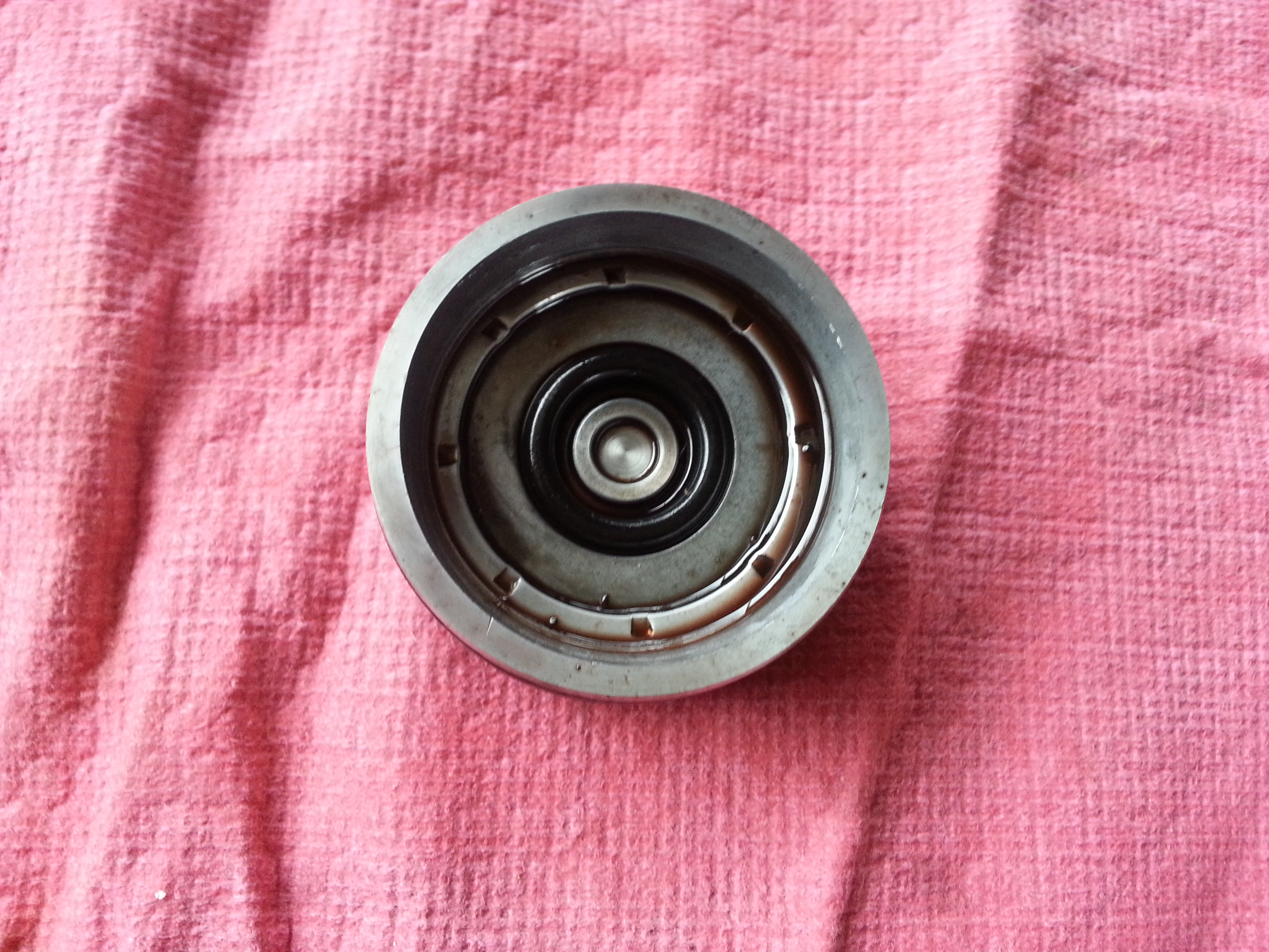

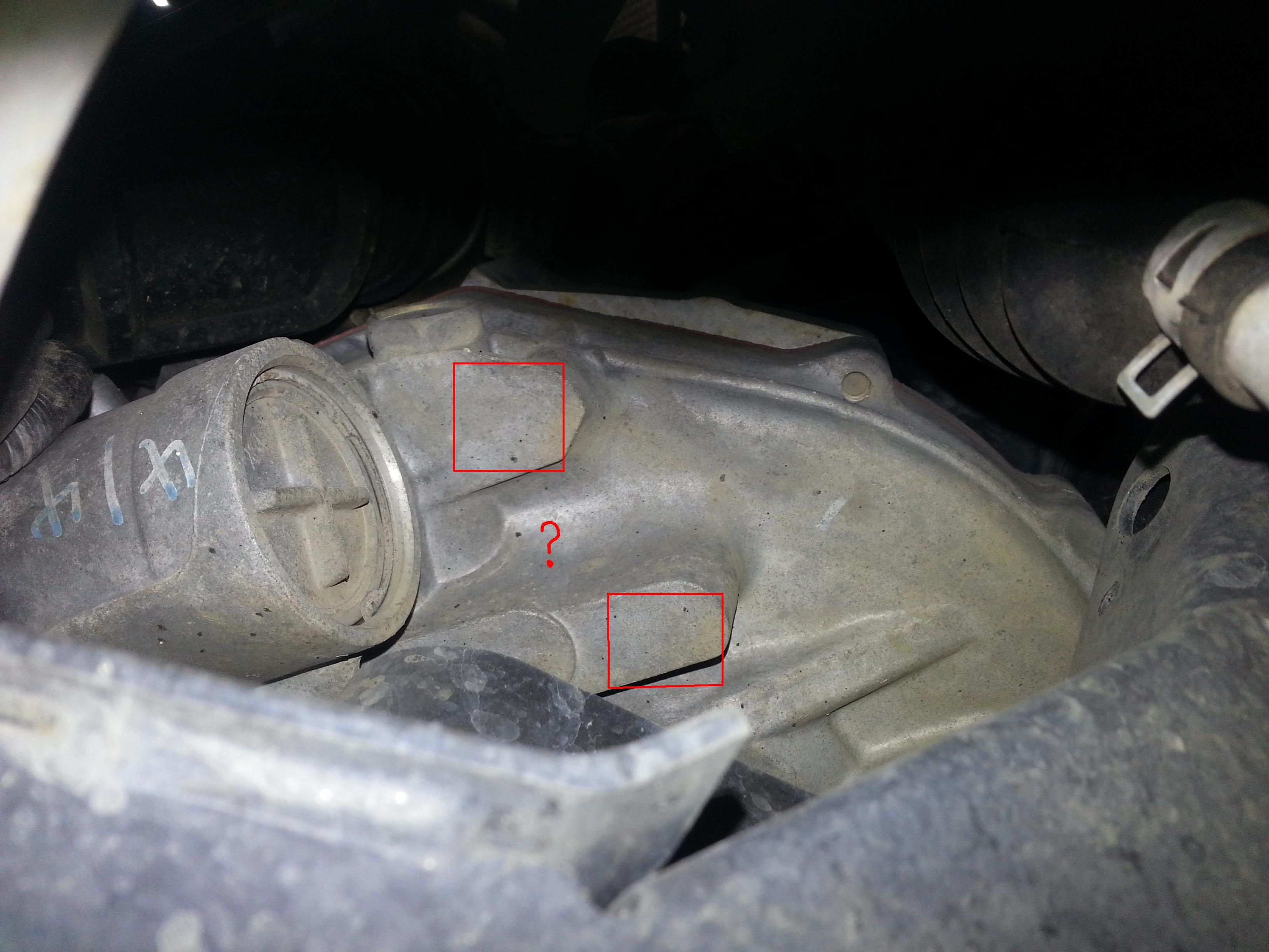

Last weekend, I made the jump to swap out the servo cover. I got the kit and got ready to do the job when I noticed that the holes that you screw the supplied bolt into weren't there. That aside, it's in a crazy tight spot that most lock ring pliers can't get to. Back to the drilled and tapped holes for the bolt, or lack thereof in my case, I would say the ability to use that bolt would have saved about two hours. After completion, I did a drain and fill on the trans. Wow! After the simple "relearn" that the instructions say to complete after installation, everything shifts smooth. All gears engage like a lower mileage trans and there hasn't been any 2-3 shift flare. Not once! This cheap upgrade is extremely valuable, but a pain to install without the ability to use the supplied bolt as a fulcrum. See pics. Has anyone else come across this problem with the bolt holes????
Old cover.
Old cover.
Si vis pacem, para bellum
