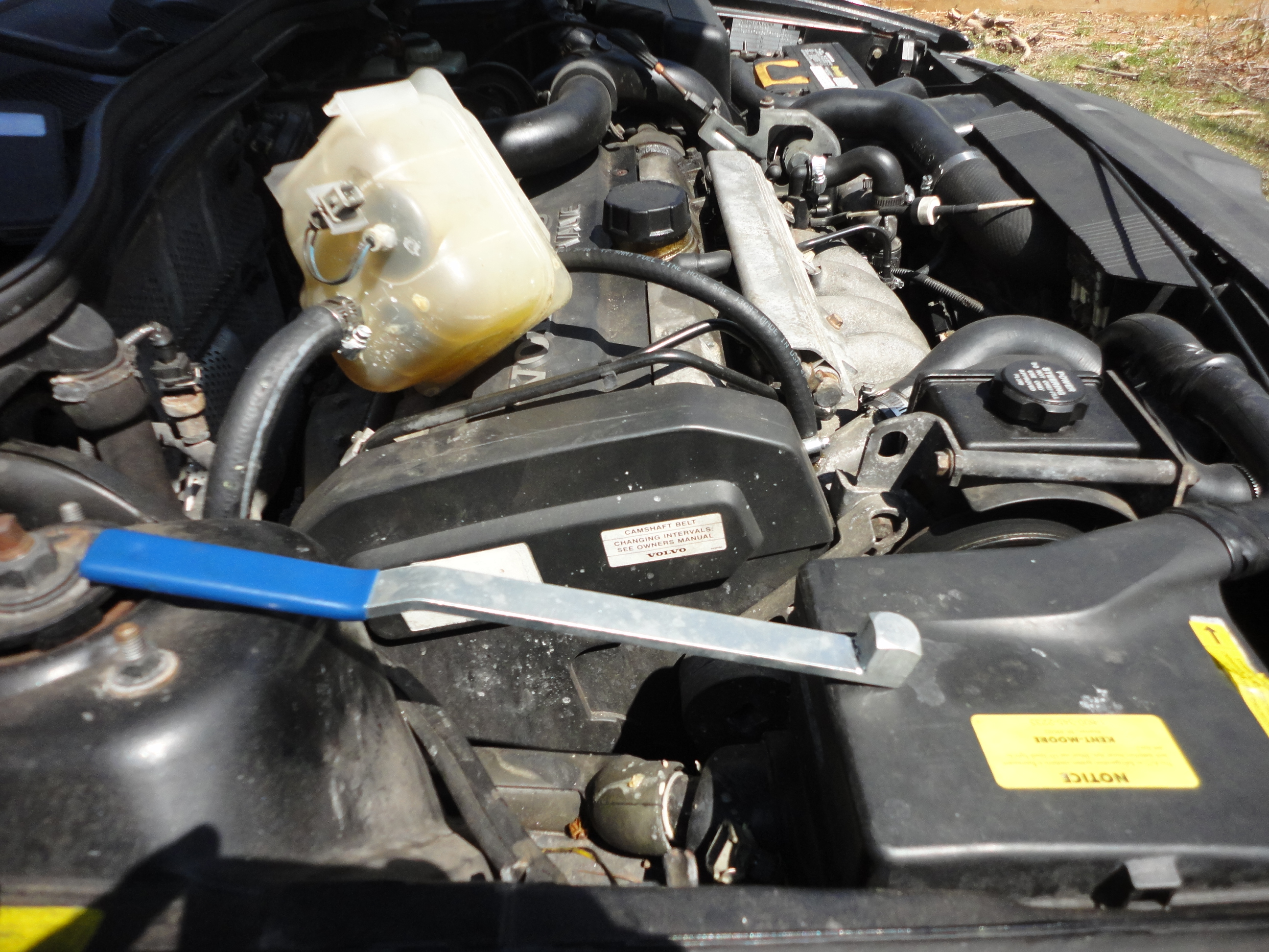

Serp belt and tensioner removed.
Removing serp belt tensioner (12mm).
Removed coolant reservoir and serp belt tool.
