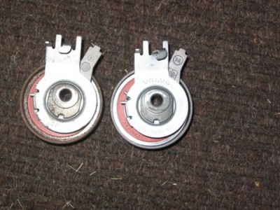

Belt looks good, tension probably needs one more adjustment, but now I have new wrinkle--the tabs that point to the block on the tensioner have bent, leaving the window over to the right. I noticed it was bent before reinstalling it this morning, so I realigned it in a vice and put it in, but it moved over when I set the tension this morning. As with the thread cited below, I did hear a 'snap' sound as I tried to adjust it yesterday....
It is an INA tensioner that came as part of the FCP kit, green box, marked made in Slovakia and distributed by 'Schaeffer Group' in California.
It looks just like this one (from a previous thread https://www.matthewsvolvosite.com/forums ... =1&t=21848)
Should I ask for a replacement as the other person did, or is it OK to use?

Decided not to use the tensioner--heading to FCP @ crack of dawn tomorrow to pick up replacement.
They very decently said they would upgrade me to the OEM Volvo blue box tensioner (although it is also INA).

If you can straighten it back out to a point where the tabs fit between the bump on the block it is fine. The tabs hold it in place as you adjust the tension but after the bolt is torqued down they really don't do anything anymore.

Did a full two times by hand, then checked the tensioner and readjusted it a second time--I had absolutely no problems with the Volvo one, although it looked identical to the aftermarket INA, except for the Volvo stamping on it.
