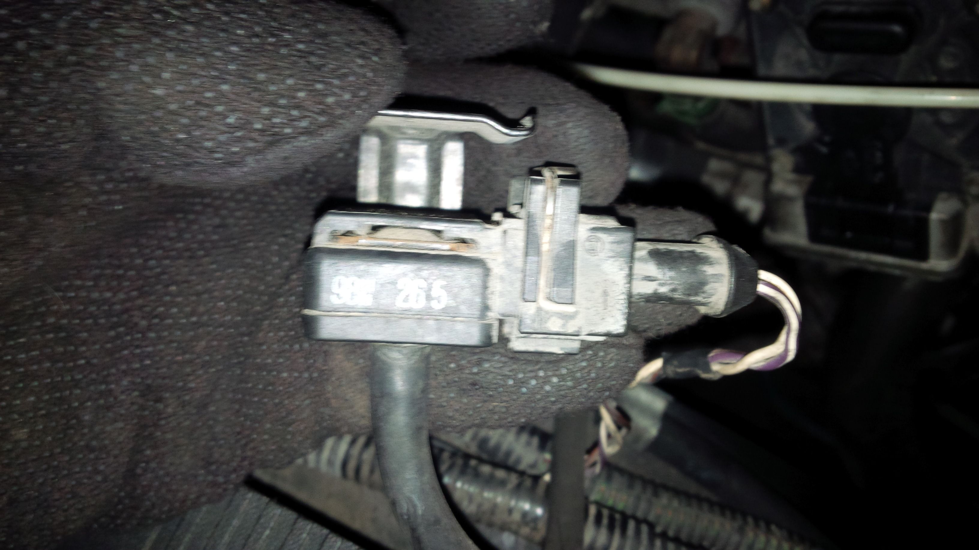

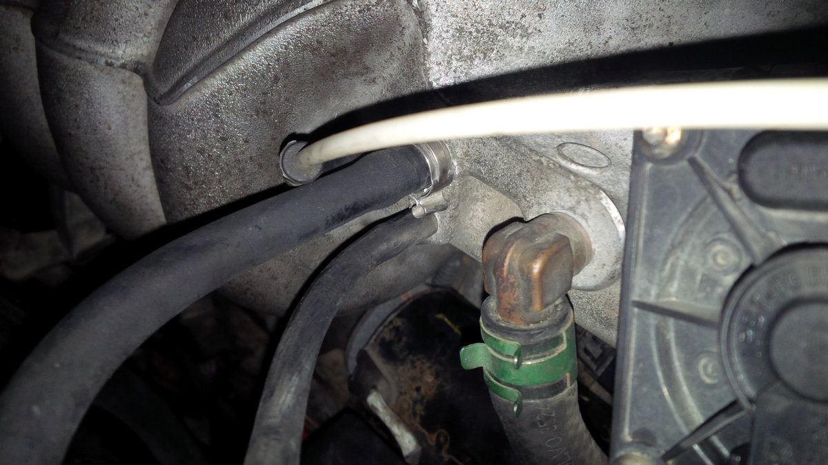

OK, I figured out what my problem was. On the drivers side of the intake manifold there are two small nipples that attach to devices, one goes to the bottom of the air box, the other goes to a small sensor mounted right above the radiator. The hose that connects to the sensor above the radiator was broken, I assume this senses airflow/pressure. Anyway, I replaced that hose and all was right again.
