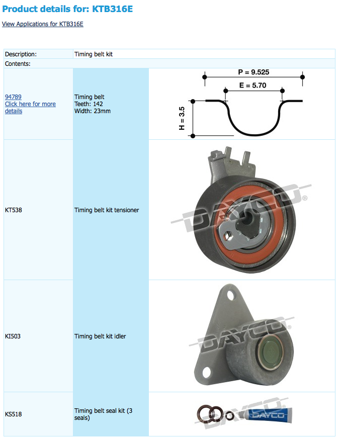

Its a spring tensioner (see screenshot from dayco website) Kit is a Dayco - KTB316E. I brought it from a seller on ebay (fusion automotive, http://www.ebay.com.au/itm/DAYCO-TIMING ... 7c6&_uhb=1), around $440. They are not cheap, but the likes of Repco, auto one, covs etc... All wanted between $590 - $700 for the same kit. Only covs had them in stock in WA too.

Timing belt is on my to do list, likely order part from USA comes in around $250 OEM all up including water pump from memory. Will get other parts at same time, have been given estimated quote on shipping $60.
Got to make sure it is the right part and they made two different tensioners apparently.
Probably will have to inspect the part myself on tbe car but as you know access is tricky. Maybe try and get info off Volvo dealer.
