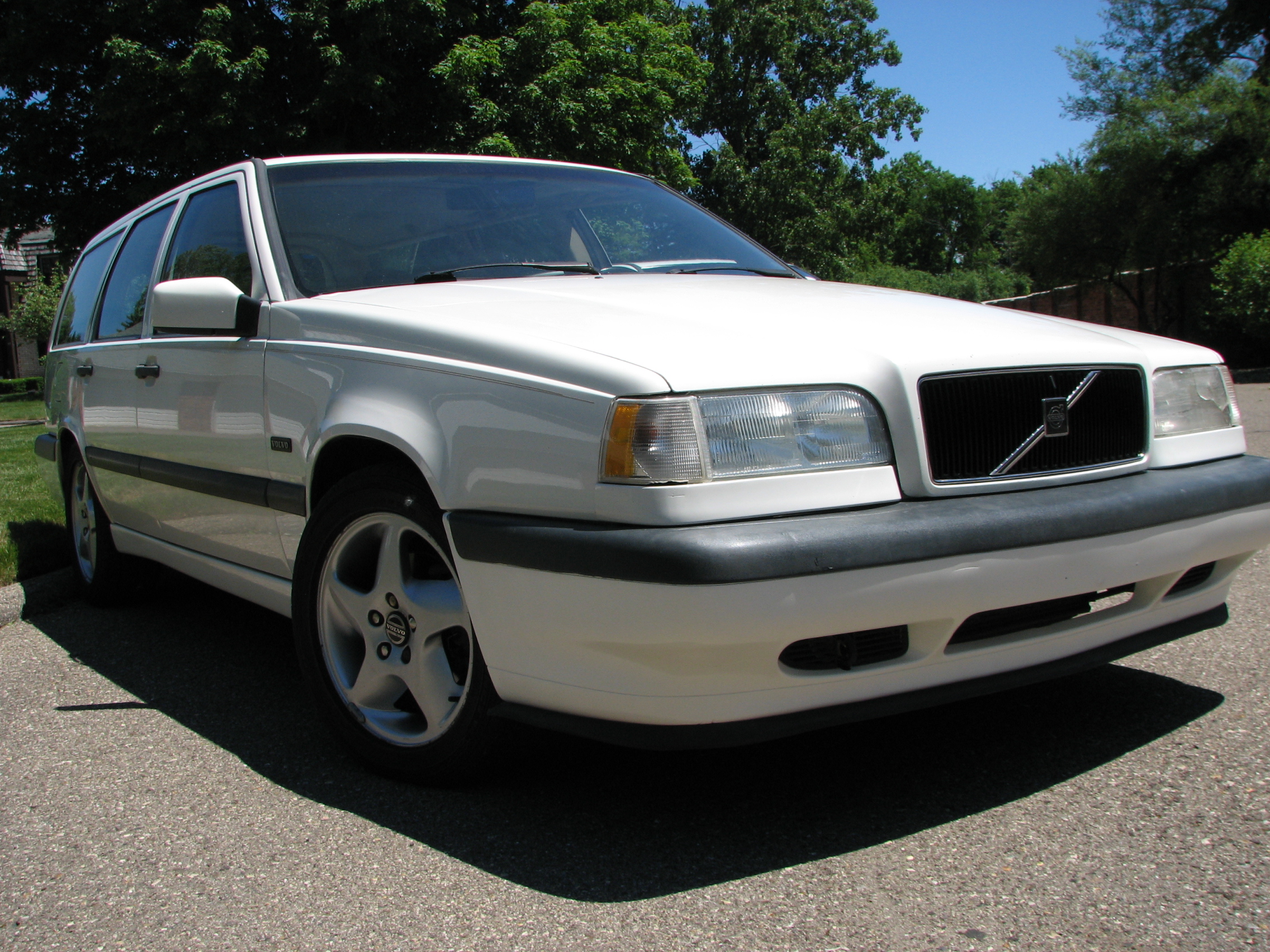

I have a collection of MAFs for diagnostics, among other sensors, relays etc...misha wrote:Check for Bosch numbers 0 280 217 107.It's the same for all of these 20v cars up to '99.AVIP wrote:Will take a look salvage yard has one for 10 bucks but im not sure the sensor is the same 96 850 to my s70?
Like erikv11 said...Doesn't matter if it's turbo or not,they are all the same for 20v cars.
Point being, I firmly believe I brought home this for $650.
Of course it needed other work, but the main issue the seller was having was the fact that it would not stay running continuously.
A MAF and a few vacuum lines later, I was a happy guy.
https://www.matthewsvolvosite.com/forums ... 35&t=56550
There were O2 sensors that I believe also played a part in the reliability/drivability. (Usability)
Sensors seem to want to be Bosch OEM designation for these cars. I have found junkyard parts that fit the bill cheaply and put a huge smile on my face.
Good luck.
