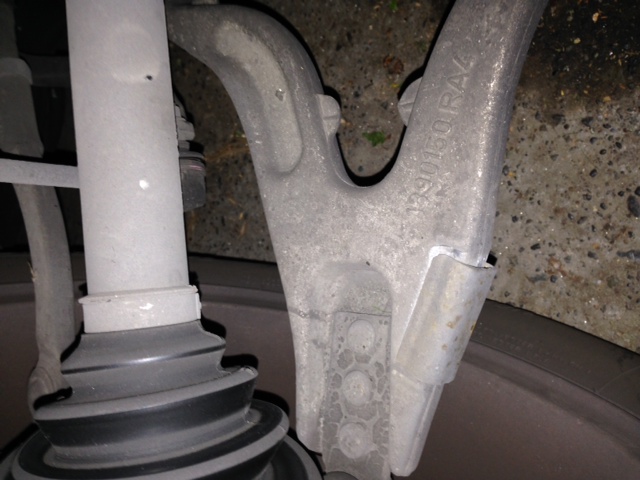

Think I solved this one: I believe my 850 has the aluminum control arms, which have small steel clip that protects the arm from the steering stop (see pic). These clips can become loose, and if loose, rattle like heck! This weekend, I'll pop it off, bend the clip to make it a little tighter, and re-install. Thanks to all for the ideas!

Also, brake dust shields. One of mine had me thinking the hub was going out until days later when I put my hand through the spokes and bent it back into position.

Also, on my '93, the caliper mounting brackets had become worn and left play.
Does the noise still occur when the brakes are applied?
How good are your control arm bushings?
They have to be press fitted on the '93 aluminum arms. You could buy the later arms that do not allow for the easy ball joint change, but I like the aluminum arms on the '93.
Oh, and I don't even have those bump stop clips anymore.

EDIT: I do still have those bump stops. I found a photo.
https://www.matthewsvolvosite.com/forums ... =14064&t=1
