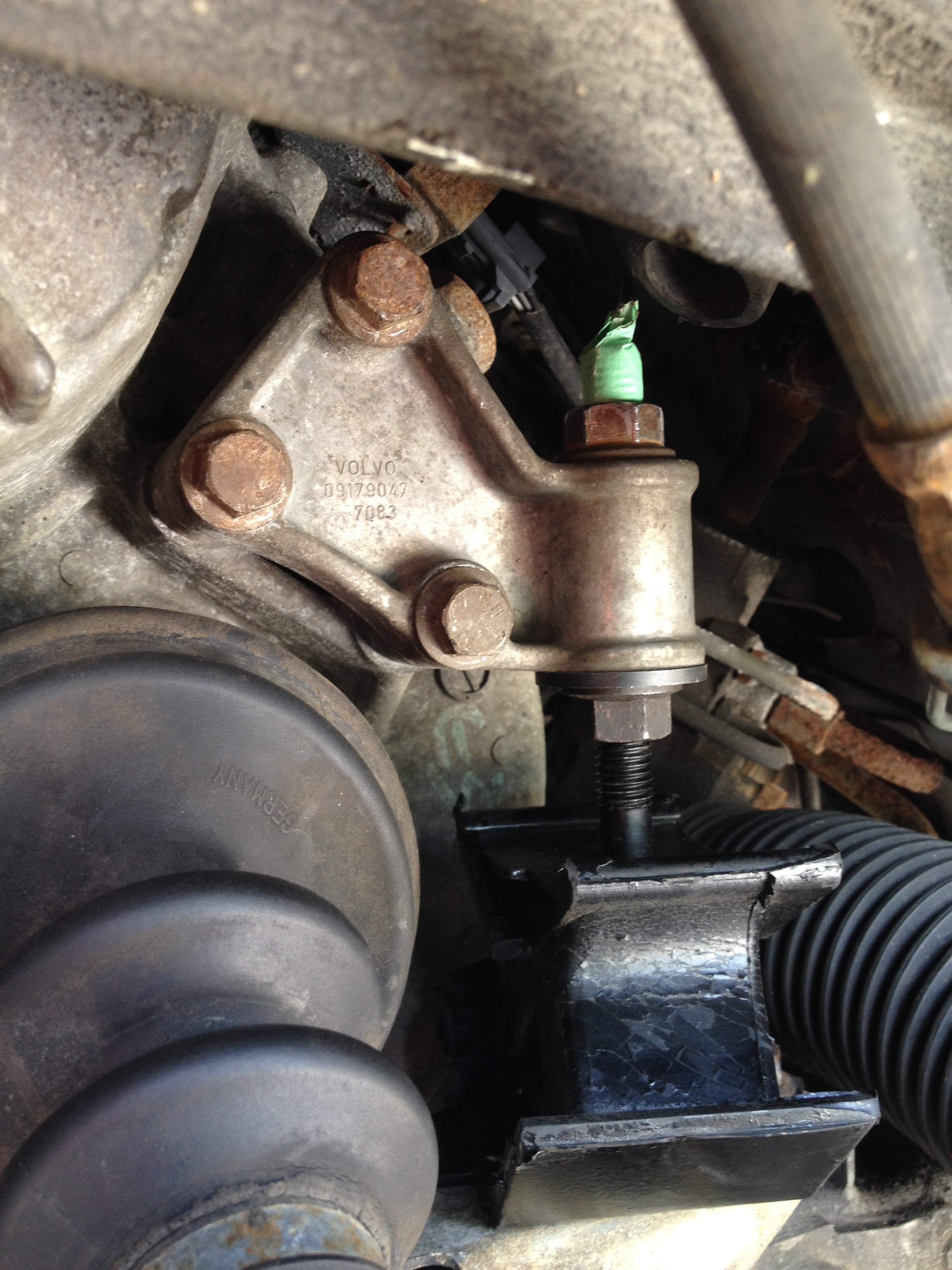

Thanks for the help. I ended up replacing the mount this past Saturday. Here is a summary of what I did.
Here is the old mount, cracked and separated. It is garbage. Here is the new mount in comparison. In the first link cn provided the threaded stud part of the mount is questioned, and no conclusions were agreed upon. Some say it's to adjust engine height during the life of the mount and others say it is for ease of installation. I found it very helpful when installing the mount.
My first thought when installing the mount was to position the engine bracket in the same position as the old mount. I did this and found the engine sagged too low for me to install the fasteners. This must be the purpose of the threaded stud. I lowered the engine bracket down the stud, being sure to mark the stock height. Installed all the fasteners of the mount hand tight. Finally, raised the engine back to the stock height. It turned out to be pretty simple.
Again thanks for the help cn90 and Lee.
Shawn

I do not know the exact cause of the problem, but I would guess it would have happened as a result of being over stressed for too long.
Brief vehicle history:
I got this car from my parents who bought it in 2001 and it has been a family car since. It has been through a PCV and Turbo overhaul, done by my father whom I greatly admire, and numerous other small and large repairs. Another large repair was the exhaust from the turbo back, which my dad and I did about a year ago. We have put a lot of time and money into this car to get it to the 200k it is at today. I really love this car and am doing everything possible to keep it running.
Engine mount specific history:
When got my licence and started driving the V70 in 2010 it had a clunking/shuddering that came from the front right side of the car. We determined that it had to be engine mount related early on, ruling out suspension(struts were replaced at some point in the cars mid-life). I'll repeat that this was in 2010, when the car had probably around 150k on it. Being in high school I didn't have the money, patience, or experience to really figure out and fix the problem. When I got to college I realized I wanted and needed to make this car last so I started looking into what may be the source of the issue. I figured maybe the engine is grounding out due to some strange torque on the engine when turning and accelerating out of that turn. My first attempt to fix this, about a year and a half ago, was subframe inserts sold by ipd. They didn't make a difference and I continued to drive the car. I even started to hear this shudder in certain situations when the car shifted gears. 50k miles later, last month, I purchased the two non-round engine mounts and four subframe bushings. I've replaced the two engine mounts so far and have finally heard this shuddering reduce slightly in intensity. My next step is the subframe bushings and the two round engine mounts. I am hoping to fully eliminate the shuddering.
My guess is the mount broke due to overuse caused the many miles traveled on multiple failed mounts. The other non-round mount probably failed first shifting more of the engine weight to this non-round mount. I'd guess if your other mounts are okay this one is okay.
Shawn
Shawn

I am "rattling the cage" on this older issue from last June. But I have found that, despite what some folks have said, this rear, Left, transmission mount is in fact adjustable. I have had trouble with a bad vibration (99XC) and when I started to tinker with the positioning of the nuts on the vertical bolt on this mount I could change the vibration dramatically. with just a half or full turn the vibration would move from one side of the car to the other, change where it occured in the RPM range, or change where it would occur with loading (hills, acceleration etc). It is easy to test if this will affect your vibration issues, and 18mm open end wrench, pull L front wheel, loosen top nut, turn bottom nut and half of full turn up or down, tighten top nut being sure to keep mount surfaces lined up, road test. continue to tinker until satisfied. Happy Thanksgiving
