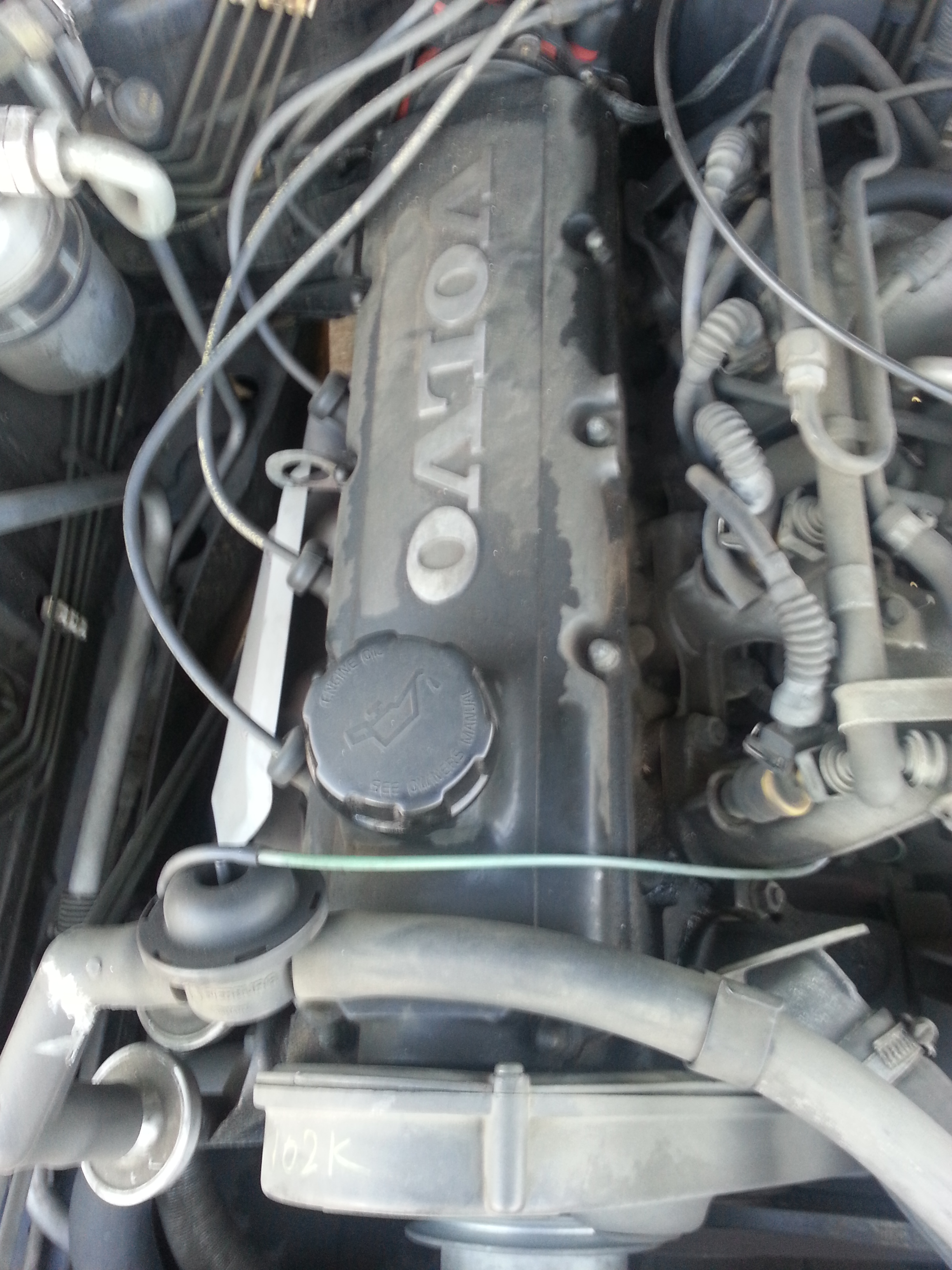

I'm looking to purchase a 1995 940 base sedan, I drove it today on a test drive and it ran beautifully with 170k miles on it. I did a thorough inspection and everything seems to be perfect except for two concerns. Please offer me any advice or knowledge you may have before I sink my money into this. Price is $2000
1. Air Conditioning works great, but it is only blowing out of the floor vents it seems. Regardless of fan speed or vent setting, even if I have it set for only the main vents, it blows only out of the floor vents. Vent knob seems to have no effect on where the air goes, but the fan speed knob works. If I hold my hand up to the main vents, I feel cold air there, just not blowing. The car does get cold from the floor vents.
2. I noticed a little darkness or 'wetness' around the oil filler cap, not like a burn just like an oily wet spot on the area immediately around the cap, on top of the engine. It could be just some spillage, or maybe was overfilled. Is this anything to worry about?

As far as the oil residue around the oil filler cap is concerned I would just clean it all off and monitor it. If it comes back it is more than likely just the gasket on the cap itself. It might not be bad at all, who knows how long it has been since the motor was cleaned. Could just be residual oil over time.
