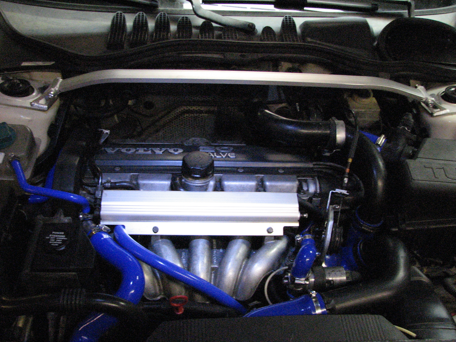

After I did this to the wagon, I also did all the above as far as ignition.cn90 wrote:1+,
This is my take at 150K miles...
Spark Plugs: Bosch copper $2/each
Bougicord: $60 at 150K
Cap/Rotor: Bosch only, about $60
TOTAL = $130
These are the best $130 to spend for 1993-1998 Volvo 850, S70, V70 (1999+ models do not use cap/rotor...).
The Ignition Coil: I went to junk yard and got a used Bosch ign coil for $10 and put it in the trunk.
Chances are I will never need to replace the ignition coil...but who knows...
I smile every time I turn the key.
https://www.matthewsvolvosite.com/forums ... =21313&t=1 https://www.matthewsvolvosite.com/forums ... 0&start=28
https://www.matthewsvolvosite.com/forums ... 35&t=47157
The wires, plugs, rotor, cap. Wires, Bougicord (Fr.), and everything else Bosch appropriate for the 850 will also put a smile on the owner/drivers face. It worked well for my '93 Sedan as well as the Turbo Wagon.
