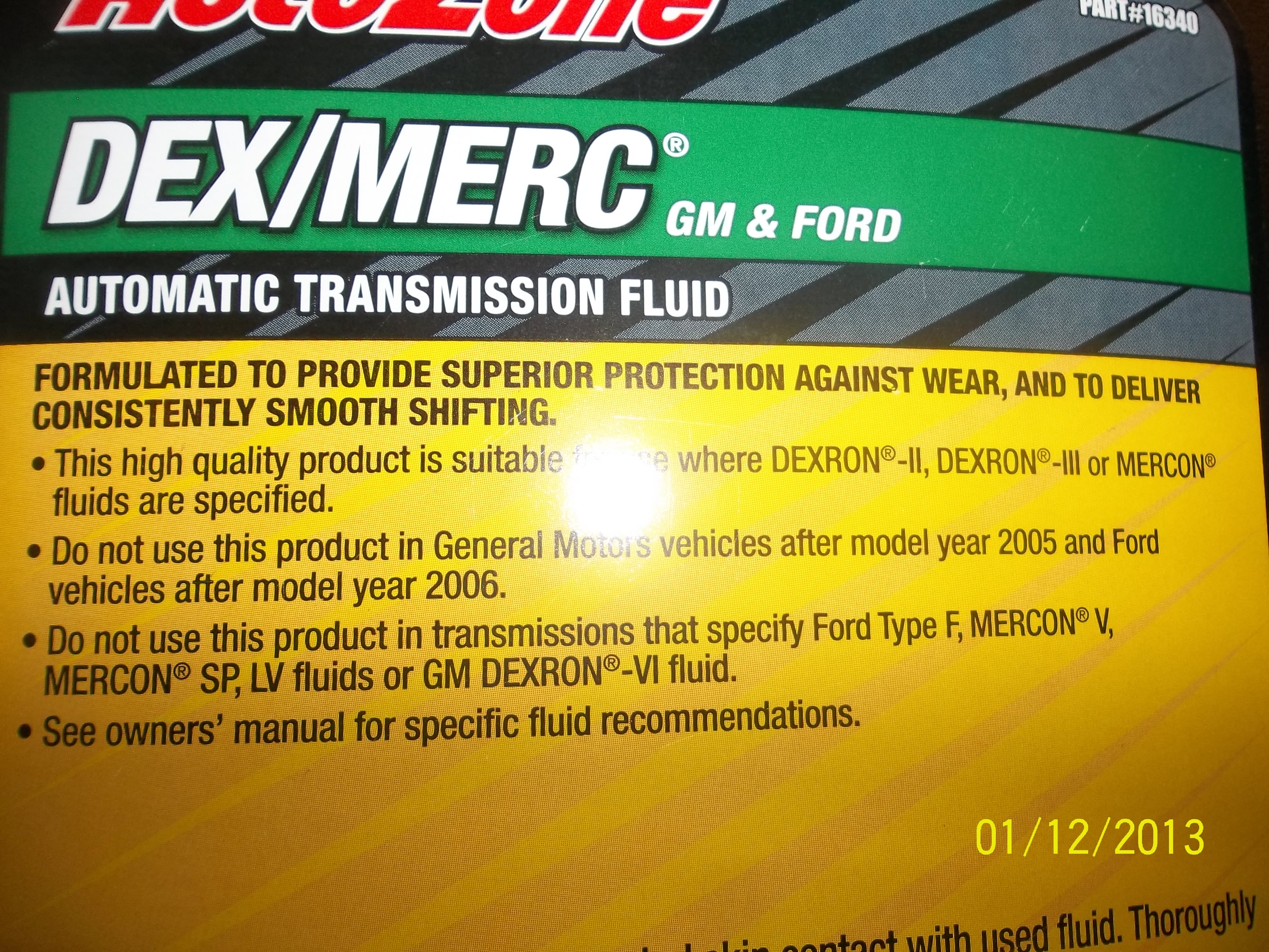

IC. well in the Manuel it actually says dex IIE so that's dex 2 right? but the dex 3 is compatible with dex2 but i never see anything about dexIIE just II, and on the multivehicle or euro import like the link sais. http://streetperformanceusa.com/i-97390 ... 4AodmD8AwA it says Mobil 1 Synthetic ATF is recommended by ExxonMobil for use in applications requiring: GM Dexron IIIH, GM Dexron IIIG, GM Dexron IIE, GM Dexron IID, GM Dexron II, GM Dexron, Ford Mercon, Voith H55. 6335. 3X, MAN 339 V1, Volvo 97340 and Volvo 97341 so the one i put in my car only says.... https://www.matthewsvolvosite.com/forums ... &mode=view it only says for use were dex II dex III and mercon fluids are specified. so i figure that means it works with IIE. I dont even no what the E means, can anyone explain. And should after the last drain and fill reset the computer and how exactly do i do a relearn proceadure. But i like that mobile 1 multi vehicle it sounds like it would be good. And my short research is seeing allot have switched to mobile syn after they got there fluid clean. I am on my 4th drain and fill with a week in between so a few hundred if not less miles, but the last one was like 3 weeks cause the weather. i think 2 more and it should be good. And how long did it take for it to relearn?
Ben850
- Posts: 1613
- Joined: 08 Sep 2011, 13:53
- Location: Michigan
- Been thanked: 7 times
You are over analyzing the names and types of fluids. For the purposes of getting the system cleaned out use the cheapest DEX III you can find (Walmart is great). Use whatever you care to spend money on after that. But it probably won't be necessary to use anything else after it is clean.
