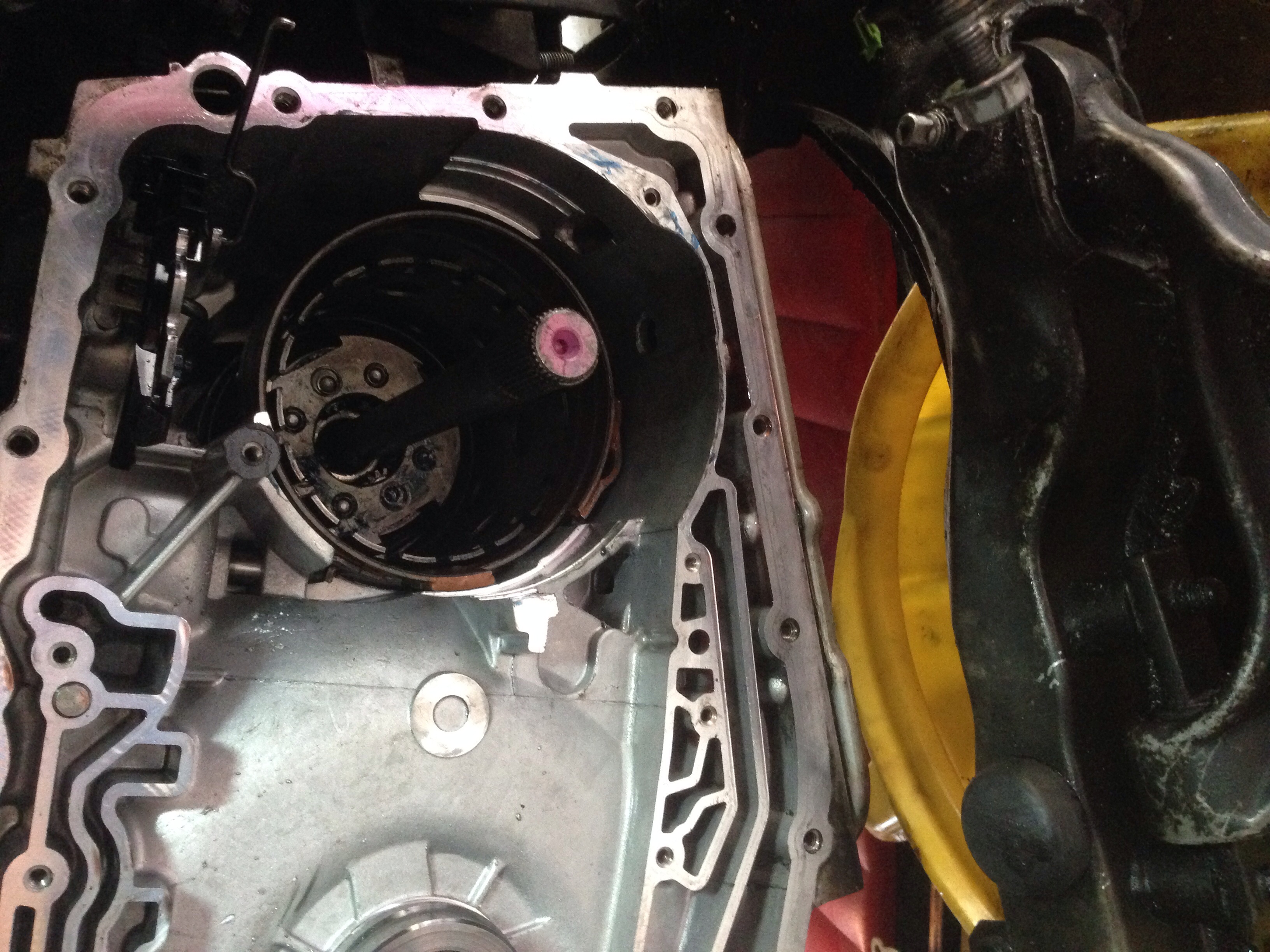

Valve body and channel plate off, clutch packs and various bits come out.  Clean everything, look for wear, missing chunks of steel.  All of my bands and hard parts were fine.

I replaced everything, but these are the real culprits.  Burned third gear clutch & ground up splines on the 4th gear shaft
