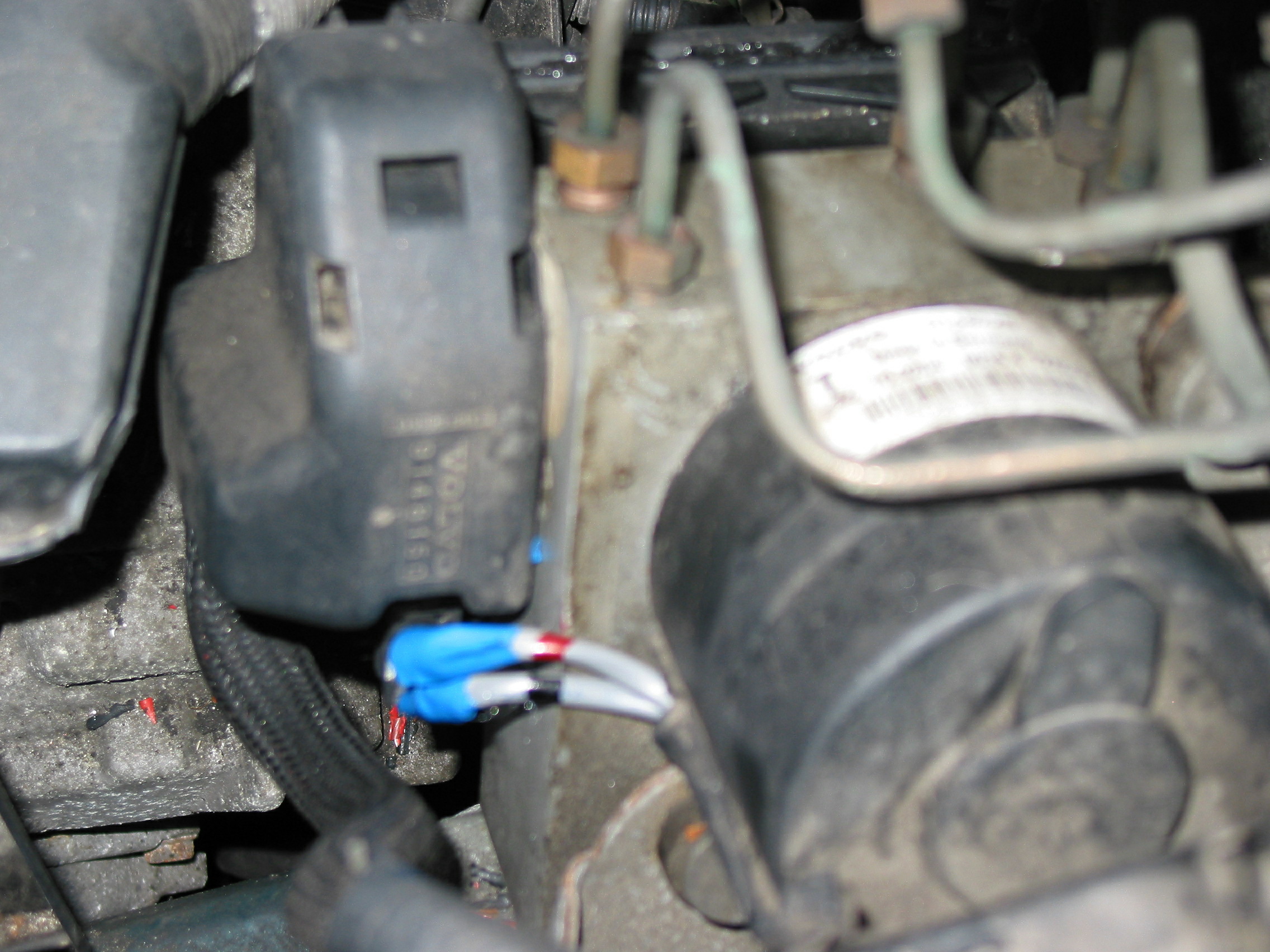

I am happy to report to you that the ABS power cable problem is fixed. Another ABS succesful repair of a different variation...
I could not find the removal tool you suggested anywhere to pull the connectors off the plastic plug. The pins seem to be molded in a plastic insert, which would need to come out in one piece. It looks like I would need to separate them.
(a) So, I cut the wires about 3/4 of inch away from the plug. So I can use new sleeve for part of the cable going to the pump.
(b) I removed all insulation debris along the stranded wires all the way up to inside the pump cover. I used a small dentist mirror and a powerfull flashlight to peek inside the "hump" along the pump cover, and removed some broken pieces of insulation with a small pick.
(c) Slipped each stranded wire cable into a sleeve tubing all the way up inside the pump cover, positive and negative cable, one at a time. I approximated the required length with a dry run first to see how long I would need. And I cut the sleeve and exposed less than 1/4" at end of the cable for soldering connection later.
(d) Before I soldered the cable with their new jacket with the plug piece, I used a larger sleeve that will need to cover the exposed cable piece cut from the connector as well as the long sleeve. I was lucky to try an old spark plug wire sleeve that worked!
(e) I cut about 1.5" from the spark plug sleeve and use that to cover the cable piece from the plug and to overlap the solder joints along the cable.
So I slid the short jacket over the long one, performed the solder connection. And sliding it back to cover the exposed pieces of cable from the plug.
(f) Finally I used a strong weather resistance electrical tape to hold the area very tight.
The final picture gives you an idea...not that difficult. I think a sleeve from a Cat 5 cable would probably be better to go over the first sleeve.
The ABS warning lights are now history. (It's been five years I wanted to fix this...)
By the way since I was in the area I decided to open and take a look at the ABS module pcb itself with a powerful microscope. The unit solder joints are still in good shape. It is sealed and put back together and everything is working.
Thanks for all your suggestions and recommendations.
