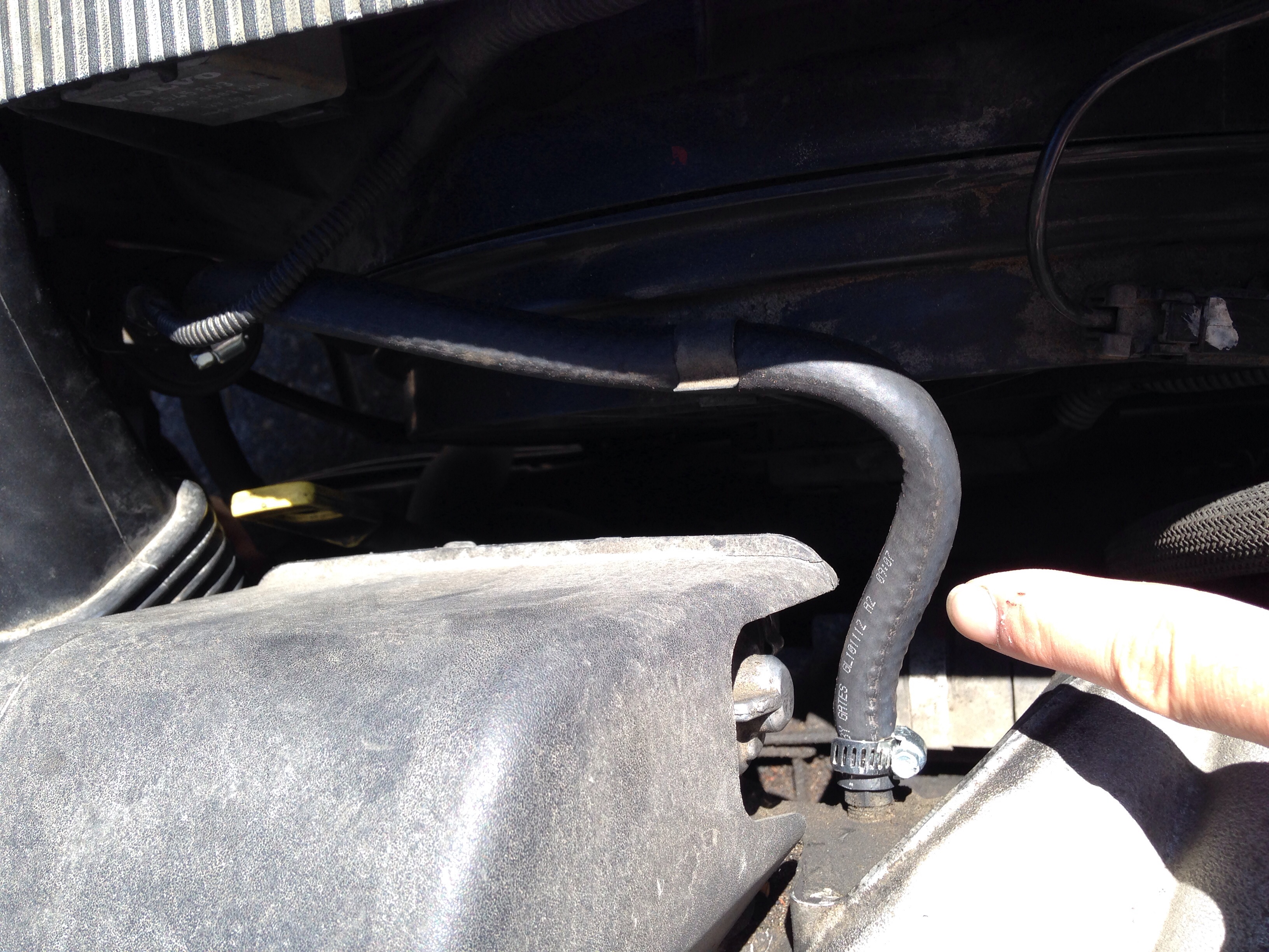

I also replaced the the hose in the 2nd picture with a generic hose that seemed to be slightly larger in diameter but it tightened down nicely. And I used generic hose to attach that vacuum to both sides of the airbox. Would hose diameter inside the hose cause any issues?
