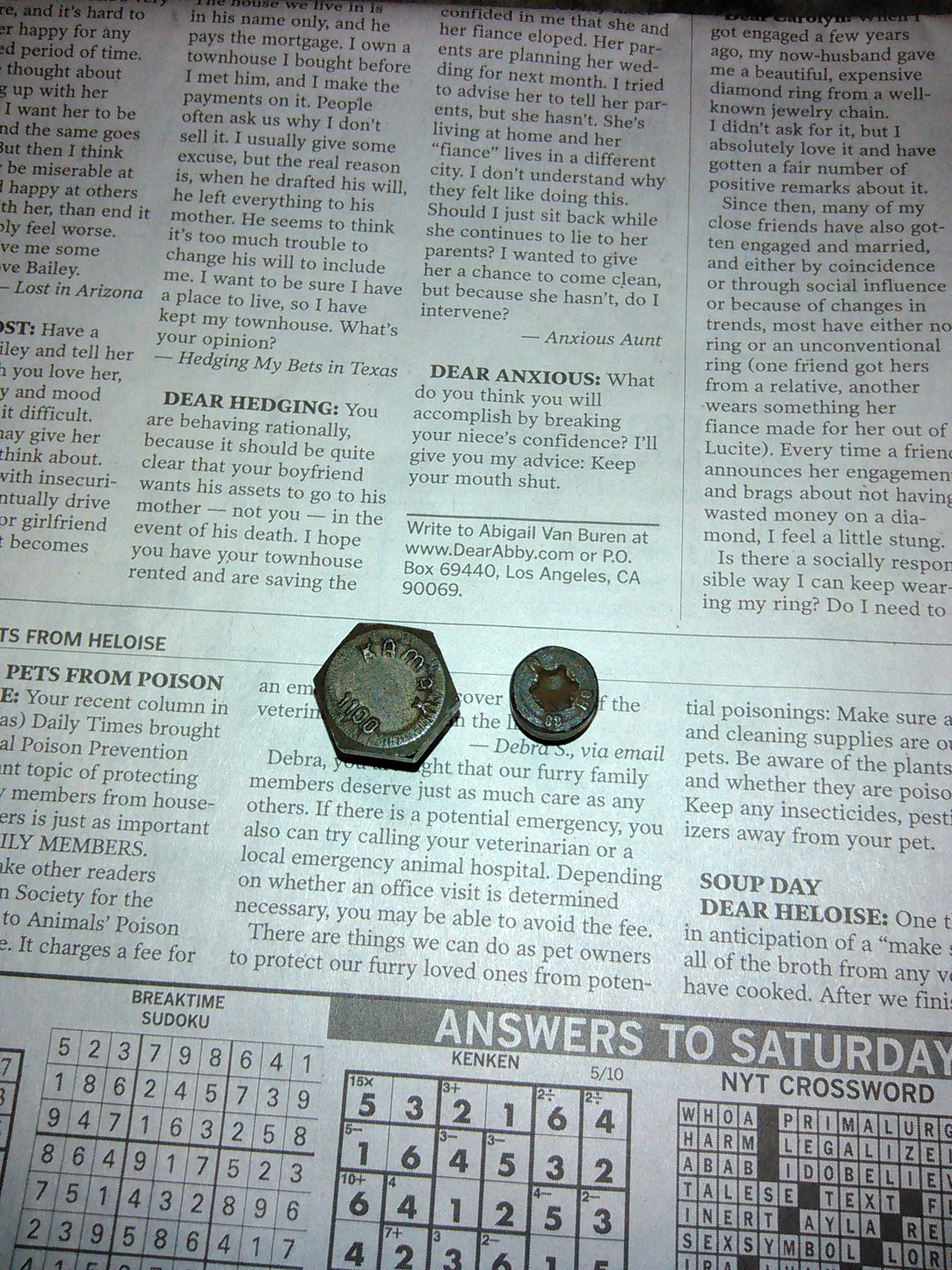

The flywheel bolts allegedly require a 12 point 17mm torx or triple square bit. As far as I can tell that tool simply doesn't exist. Does anyone know where to get it or another way to install the flywheel bolts?

My flywheel bolts came off and went on with a standard 12 point socket but, as I recall, it was a SAE size that actually fit well but I can't remember the size.
I was planning on doing a writeup on the clutch change and I took a bunch of notes along the way but after the project drug on for a couple of months due to my work schedule and crappy weather I quit taking notes and pictures and just got the car running again. I doubt I can find the notes but I will look.
Some of the flywheel bolts may be different, post a picture of your bolts.

These are the bolts I got with my M56. The left one is a flywheel bolt the right is a pressure plate bolt.
These pressure plate bolts have a 6 point 18mm head. I was going to replace all of these with new ones but all of the new bolts I found online require a triple square 17mm bit which is impossible to find.

16 and 18mm triple square are common but no set that I've found includes a 17mm.

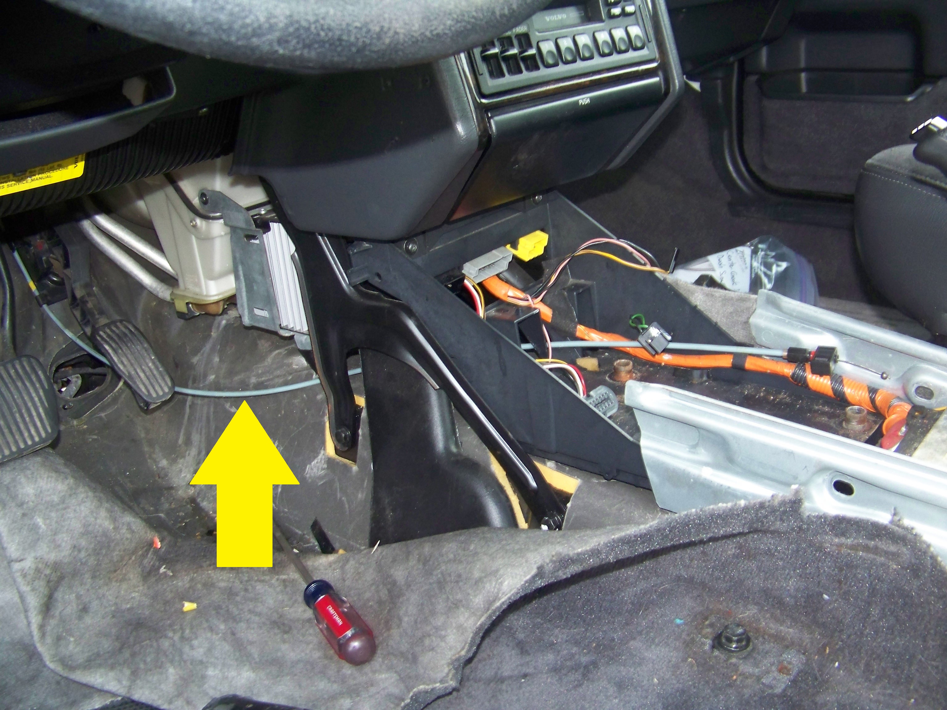

First off, this cable that attaches to the base of the automatic shifter runs up and behind the dash somewhere. What do most people do with it when swapping over to the manual? Leave it in? Remove it completely? If it should be removed where does it terminate in the dash?

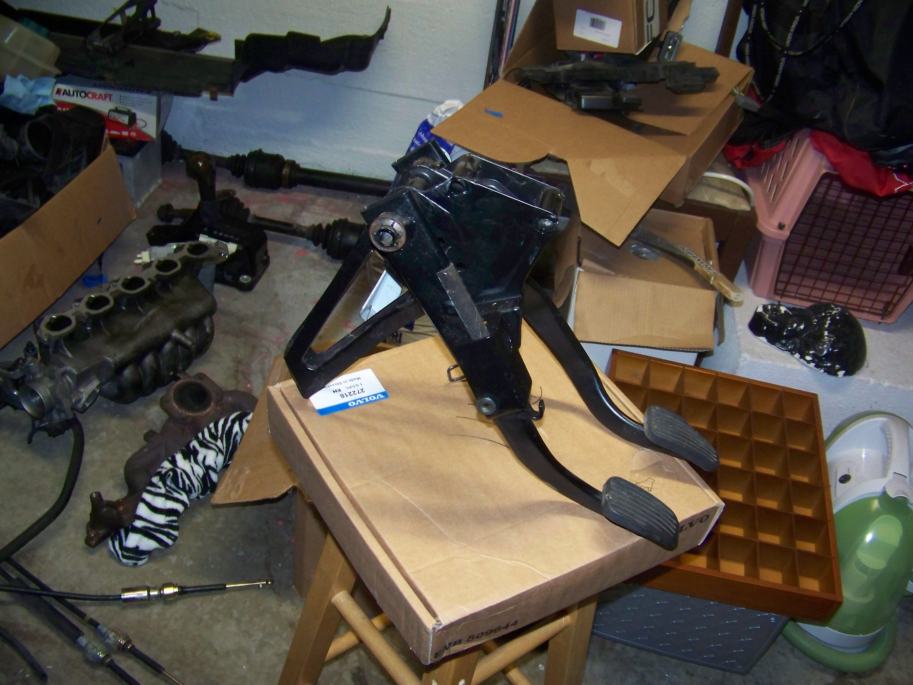

Second, I'm unsure of the orientation for the brake/clutch pedal assembly. Since the pedals can rotate freely around their axis I'm not sure which way the assembly should be installed. Does this look correct or is it upside down?

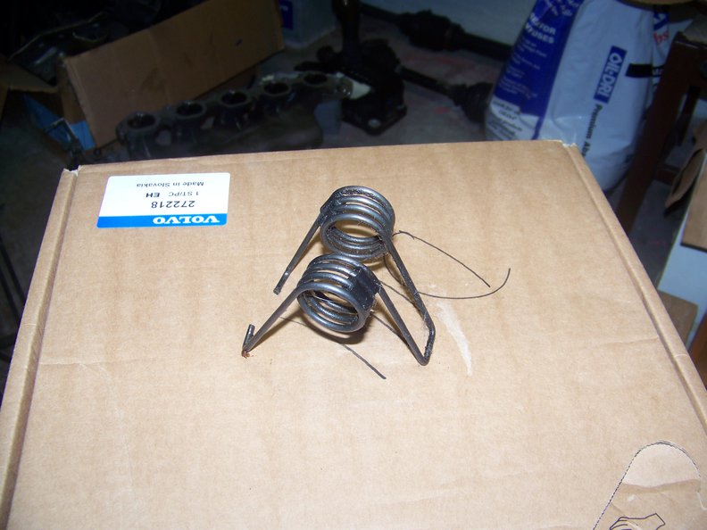

Related to the pedals, how does the spring fit on this assembly?

I found this diagram which answers my questions about the pedal assembly.
Any thoughts on that shifter cable?

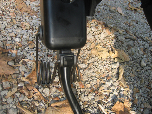

After searching for a long time I finally found this picture:
In it you can barely see that the end of the spring that attaches to the clutch pedal itself has some kind of plastic clip. Any ideas on a part number or where I can source that clip from?
