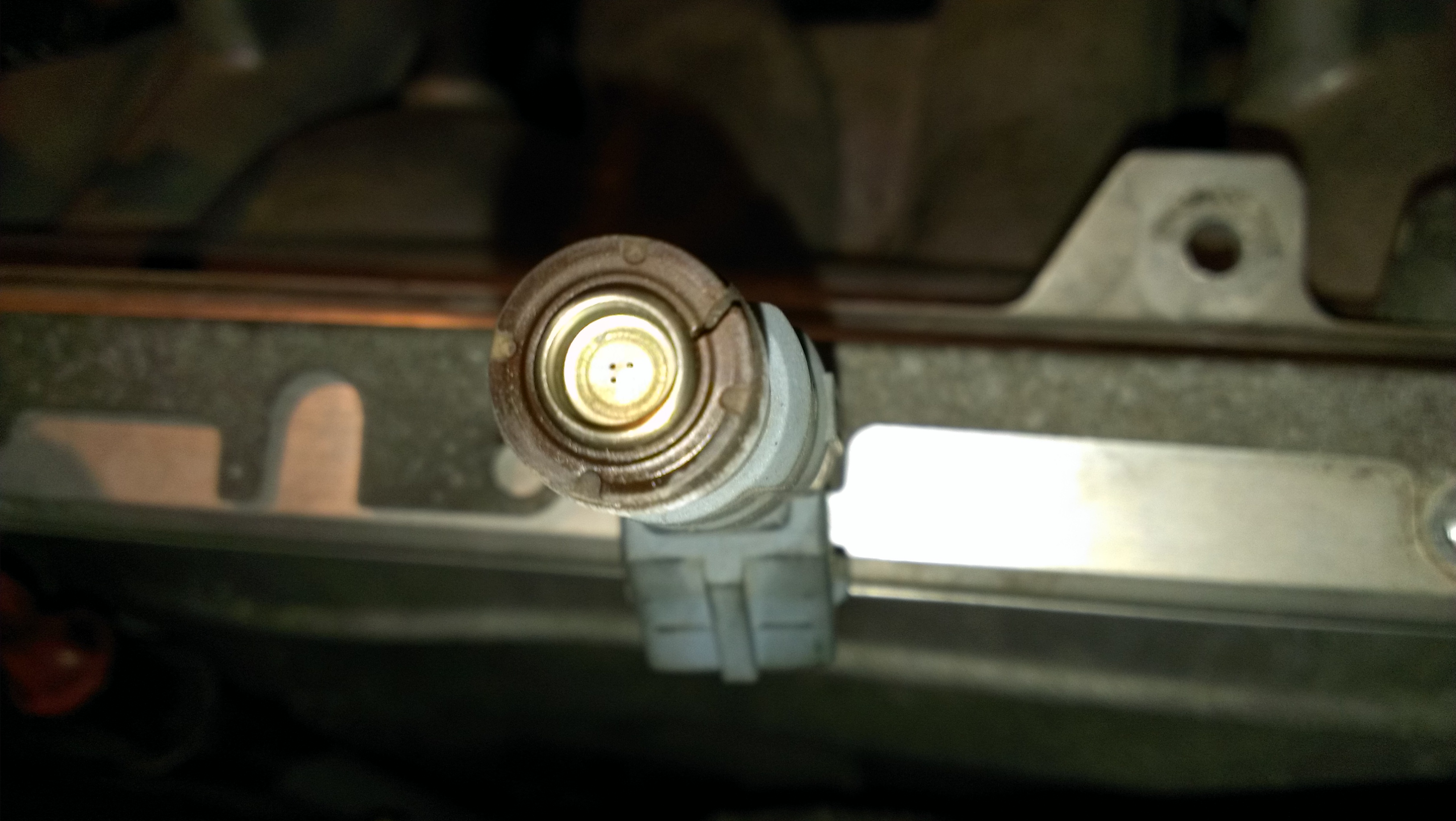

taking out the fuel rail and injectors on my 99 T5, i cracked the pintle washer on injector #4 (see attached). do the parts in the links in this post work for the blue T5 injectors? has anyone got a more reliable source? i'm moving at the end of the month so the car needs to be operational by then, and i am wary of ebay sellers and shipping speed.
uuuuuuuuuuuugggggghhhhhhhhhhhhhh

One of the great things about eBay is that most sellers have superfast response time for shipping. It's part of the culture and has overwhelmingly been my experience. Check the seller reviews, if there are no complaints about shipping time then and they are in the US then don't worry at all about that part. I'd drop the $10 and order one up. Or spend $20 on a used blue injector (again, check eBay or post up a wanted ad here) just to make sure you can drive the car when you want to.
To your main question: I don't have experience with the injector parts for blues so can't say for sure, hopefully someone who does will chime in.

i've read that the injectors are all the plastic-body Bosch Type 3 units, and the washer-style pintle cap should work for mine as well.
i'll buy a kit, give it a go, and report how it works out. you're probably right about the ebay sellers - i ordered a book with free shipping on july 2, and it arrived on the monday after the 4th weekend.
