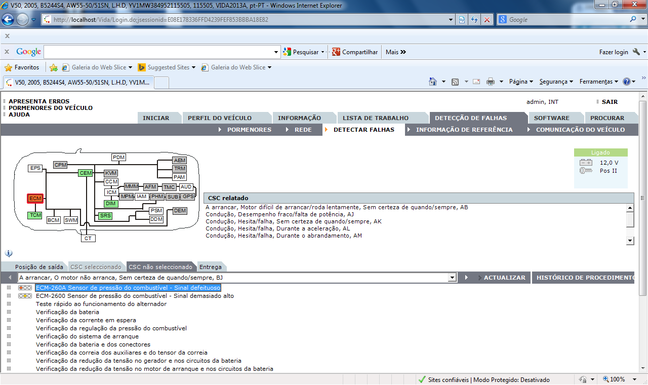

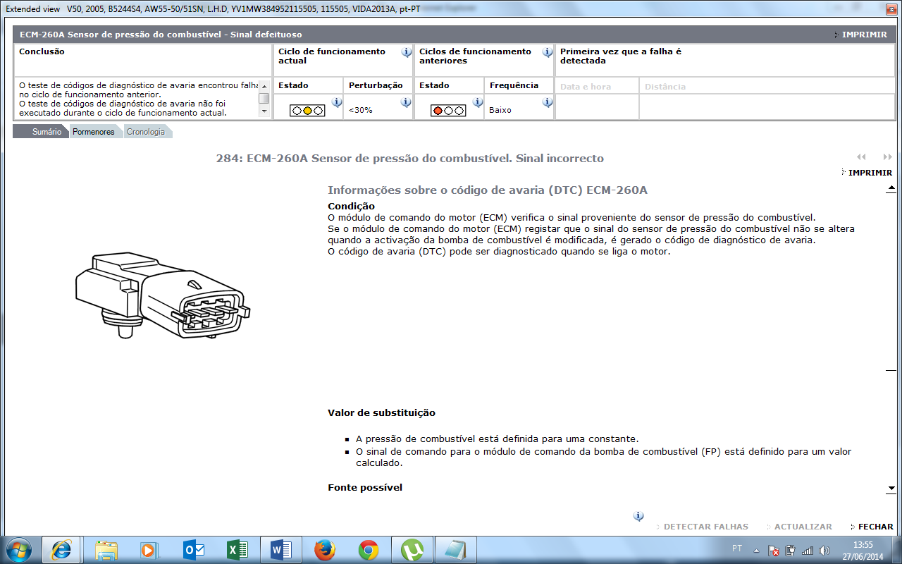

Hi
I use dice tool in my volvo v50 2.4 2005 no turbo
I found this DTC
ECM-260A
I do not know if I need replace the fuel pressure sensor or the fuel pump? Can anyone help me?
