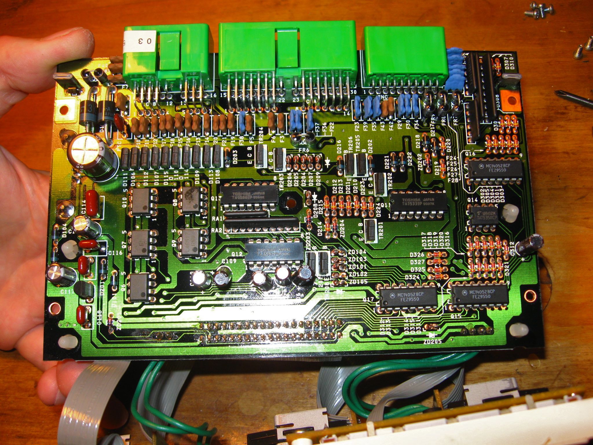

Ben850, Do you mean change the capacitors within the ECC unit as a preventive maintenance?Ben850 wrote: If you still are using a unit with capacitors, I would change that out before the inevitable. It also may be giving you false codes.
For some reason, I can't clear the codes, and none of them seems to be correct. It looks like they are old error codes from many years ago that have never been cleared. I can't clear them by holding the button pressed for 6-7 seconds. Can you tell me your steps to clear the codes and the pins that you connect to?

Not the capacitors, the complete unit. It sounds like the capacitors have gone already.Redneck wrote:Ben850, Do you mean change the capacitors within the ECC unit as a preventive maintenance?Ben850 wrote: If you still are using a unit with capacitors, I would change that out before the inevitable. It also may be giving you false codes.
Being a '96 it should not be the old type with caps anyway. Someone must have changed it out before.
Either that or the capacitors you are speaking of are not the ones in question. Can you take a photo?
'95 through '97 were updated to a more solid state design that deleted said parts. One of those units is what you want. Then you should be able to clear codes.
You have to read ALL codes before you can clear them. You will know you have read them all when a duplicate comes up.

I read all the codes and it still didn't clear them for some reason. I think that all of the ECCs even the latest ones have capacitors. I don't think it is possible to have an electronic board as complex as the ECC without having a single capacitor. The capacitors looked fine, not bloated, but could be dried out to some extent.

- jreed
- Posts: 1665
- Joined: 08 Mar 2009, 05:43
- Has thanked: 384 times
- Been thanked: 221 times
I took a photo of the backside of the ECC board from my '97 855 GLT showing the electrolytic capacitors. I replaced these capacitors a year or so ago as preventative maintenance. It was working fine before the replacement, and it's still working fine now... it probably was not necessary. People with earlier versions of the ECC board have reported problems with burned diodes and capacitors in the upper left corner of the board.
Regarding clearing the codes, as Ozark Lee said, after reading all codes you have to press and hold the button for about 6 seconds. Then after you release there is a pause and the light comes back on. Then you press and hold for a few seconds until the light turns out. Then you should have cleared all the codes. You can read them again at this point and you should get "1 1 1". If this doesn't work, there may be a problem with the code reader or more likely the ECC unit itself.
