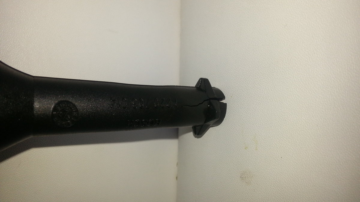

Sudden rough idling and eventual CEL coming on. XC90 T5 AWD with 162,500 miles. Just had oil changed in the last 24 hours, air filter replaced, shot some seafoam into tank and filled w/ 93 octane. Been very gentle with it since I got it 3 or so days ago. Even put new tires on it. Now I'm just stumped and worried it could be a major repair. Some thoughts and insight would be appreciated. Many Thanks!
As per my friend Stew suggested, I got the code read and it said Code P0302, cylinder #2 misfire, so off I went to meet up with him and we removed the coil pack from cylinder 2 and the boot that fits right below the ignition coil was the culprit. It had a tear in it which may have caused it to idle roughly. Everything is running smoothly once again and the CEL has been shut off.
