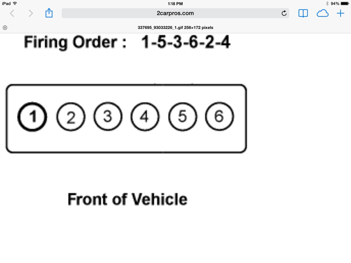

Does someone have a diagram or layout of the cylinders on a 2.9 S80 non turbo? I keep getting a P0306 code and it runs like crap. I changed the plugs, and swapped #5 and #6 coil packs around(i think) and it still shows a P0306. If standing in front of the engine, which is #6?? Did I switch #1&2 and not #5&6?

If you stand in front the car looking at the engine :#1 cylinder is the last one on left hand side and #6 is the last one on your right hand side.Hope it helps...

I got it fixed...thank you. Was a coil pack...

It's common to accidentally swap the coils for #4 and #5 for eachother. They should face in opposite directions, and while you're there check the ground connections to the cam cover, and the braided flat grounds from the head to the body. They have to clean and tight.
