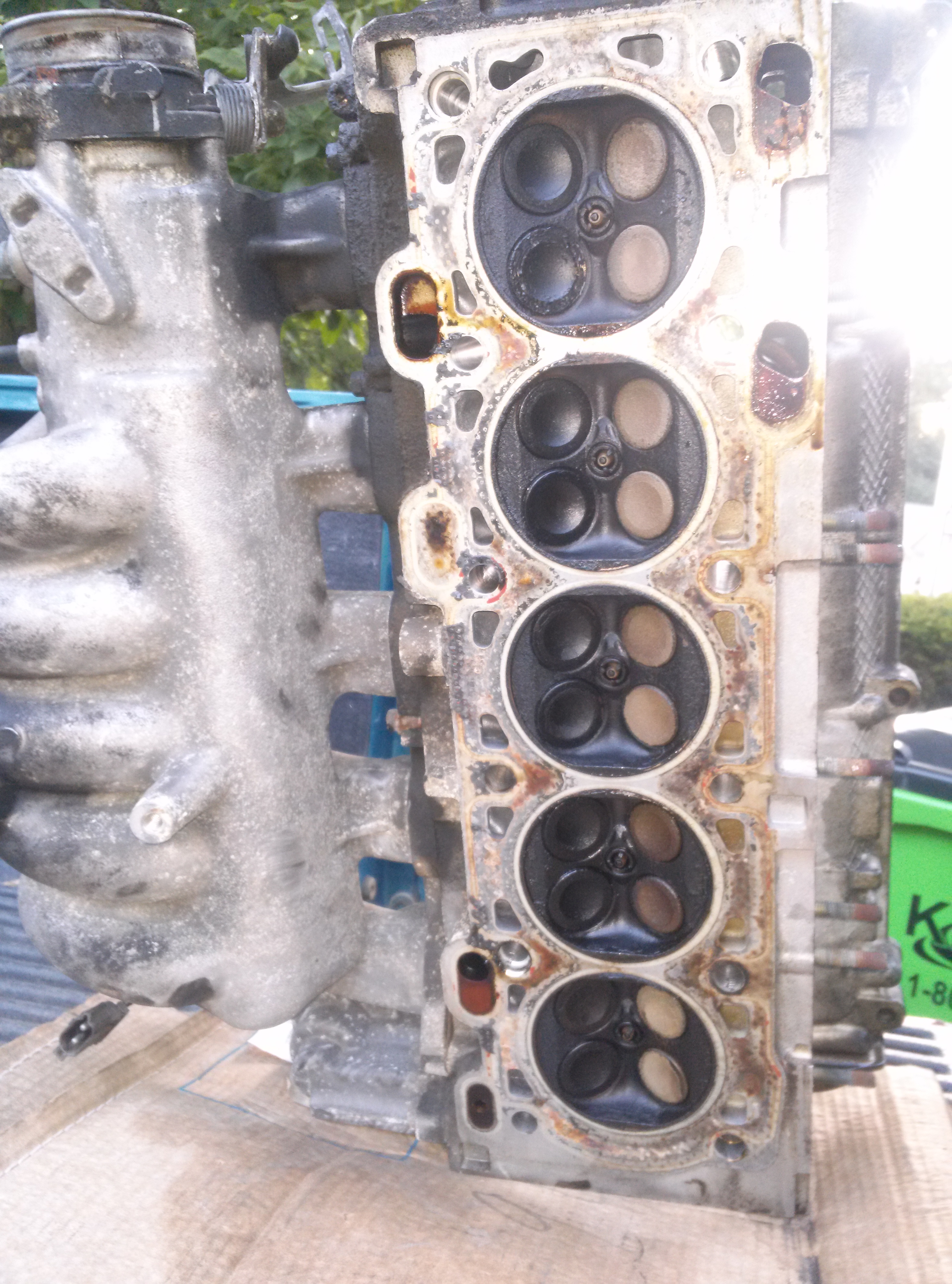

Got the head off and home. Broke a 3/8 breaker bar and a ratchet on the head bolts. :x good part is, someone had come and taken off the exhaust manifold! Yay!
Car seemed to be well taken care of mechanically, showed 210k on the odo with miles showing on the trip odo, so I will assume correct mileage.

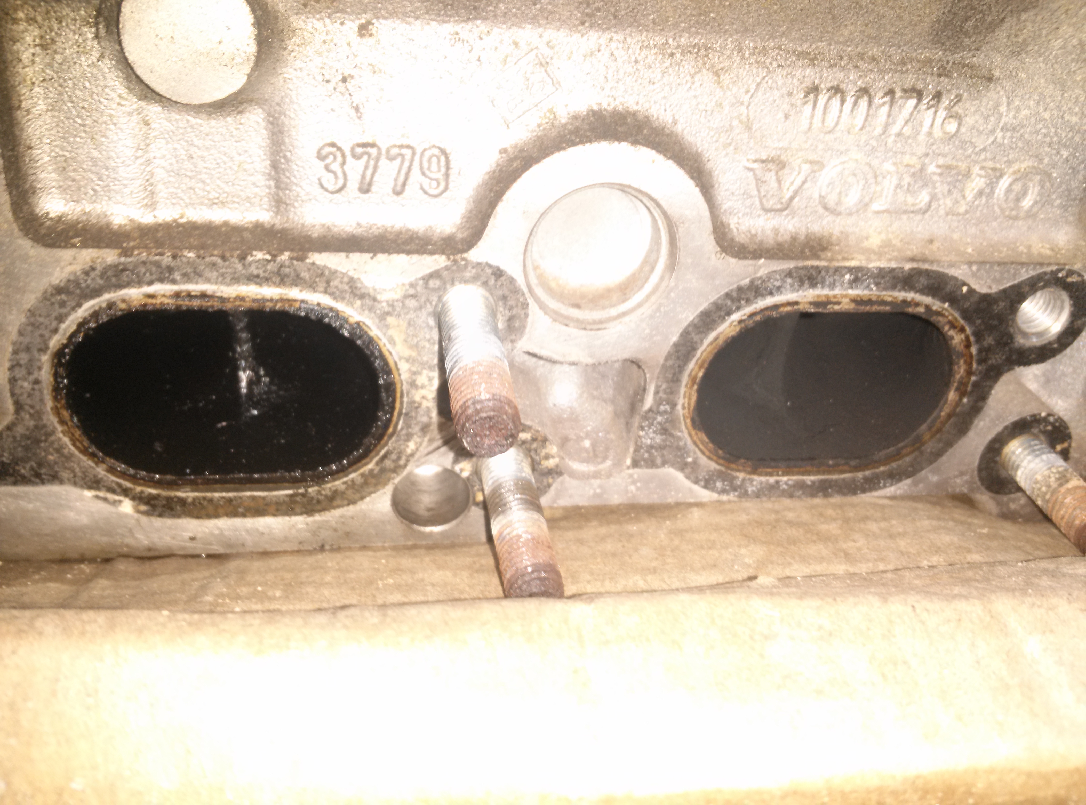

I do think.the valve seals were shot, as 3 of the cylinders have oily exhaust ports.

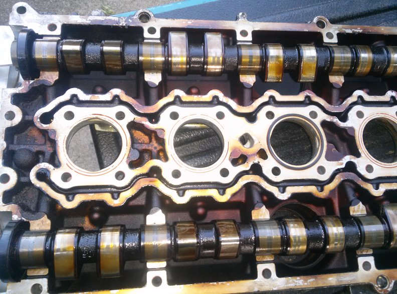

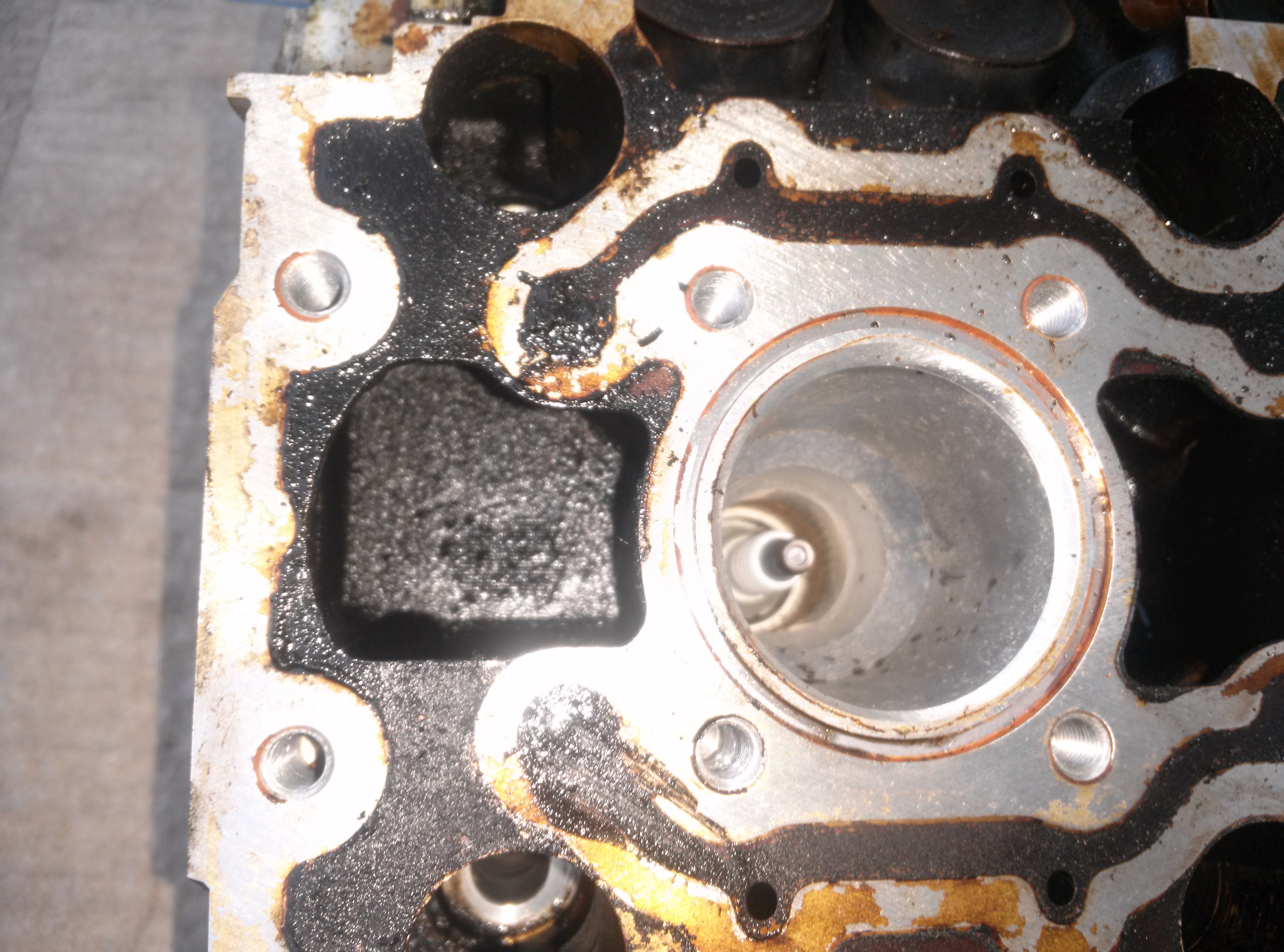

There is a good amount of sludge buildup in the oil passages on the top cover, so I think I will have the head an top cover tanked before the head is decked.
Best part, I left the intake attached to the head, and they only charged me for the head. :D
Here are some pics.
Not a bad score at the pull a part.
