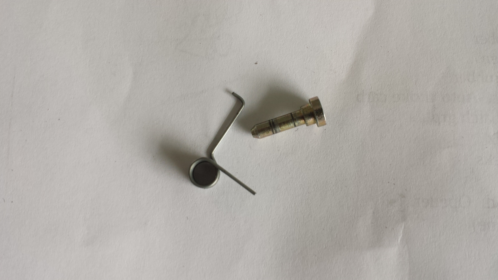

A long time ago I removed my damaged glove box, as I had damaged it when the lock broke and recently I purchase a replacement AND it came with these 2 parts (that I had too! from when I took mine apart).what are they?
If I can solve this, I can then add a pictorial of my modifications that now allows me to open the glove box even with it locked!

Maybe it's part of the latch.

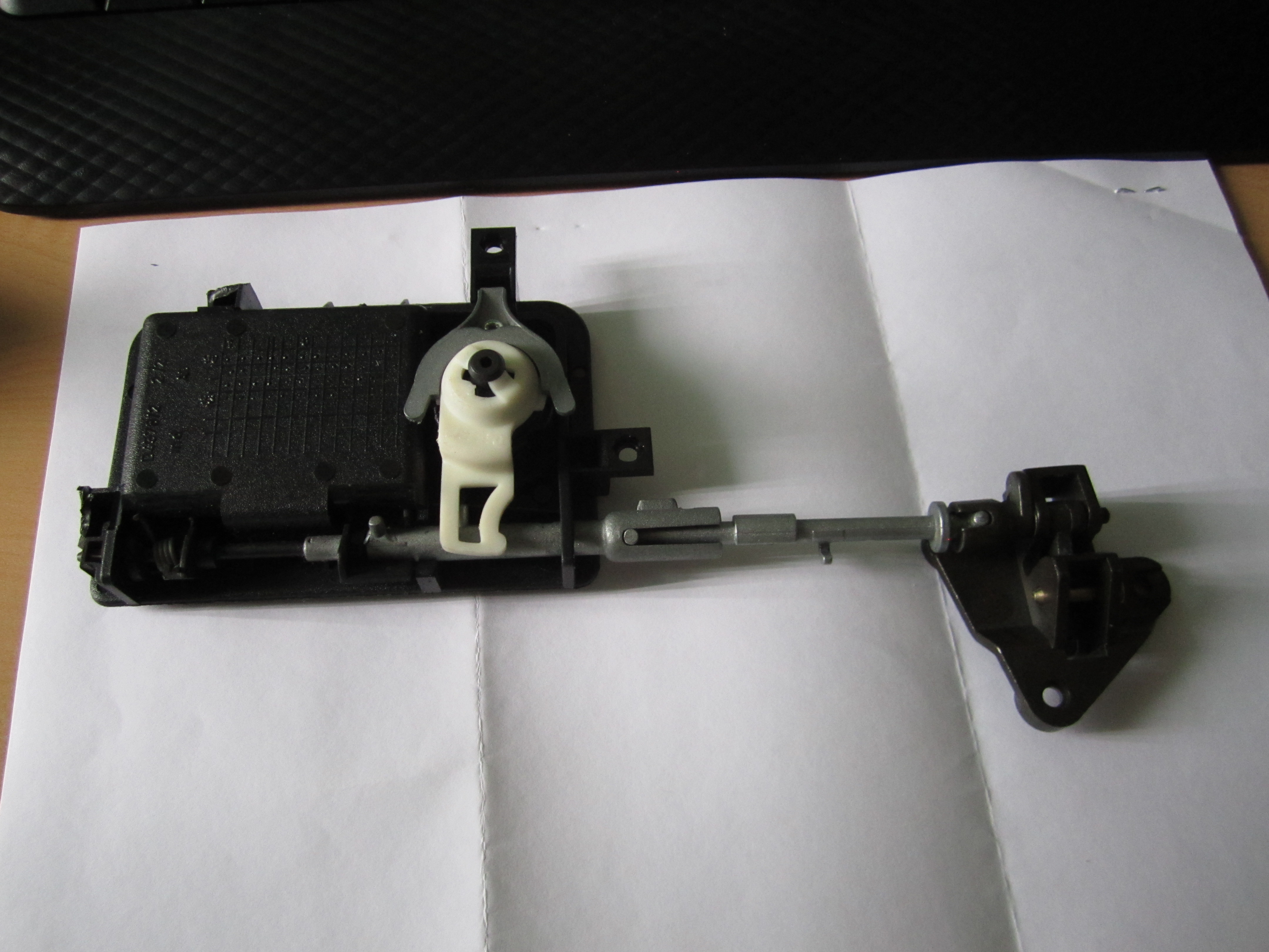

Hi Adrian,
Unfortunately, I don't have an 850 to go and pull apart any more, but I did find a bunch of left over parts and have cobbled them together (as best as I can remember) and attached photos that hopefully answer your questions. It was a long time ago since I did this ( > 1 week with my memory!) so the layout should be close.
850 latch assembly
850 latch assembly
Latch end of assembly. Pin is the brass pin. Fits one way only!
Lock assembly housing
Spring fitment in lock assembly to pre-load connecting rod and latch

Brilliant!! I now know where the pin fits..it is in the second picture, I just need to understand which way the sprig wraps around it...MANY thanks.
