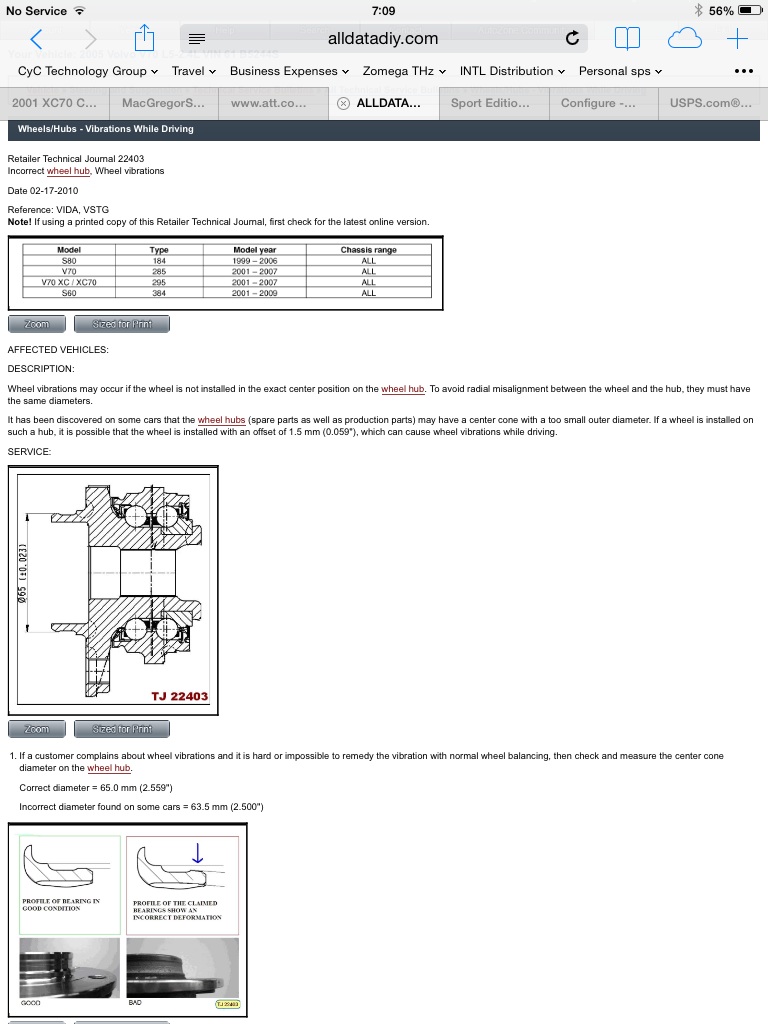

From 2010 Volvo publication 22403 outlines a potential problem with wheel hub diameter manufacturing defects. If you are having excessive wheel vibration on a 2001-2007 P2 car, this might be worth exploring.

Can you post the TSB or detail words from it?

Summary

Thanks. I'll put it on my list of things to check next time I have the wheels off.
