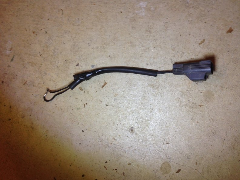

In fact, behind the black plastic container for the ECM and TCM, I found this:
It was plugged in. I unplugged it and read 13.4 volts +/-.

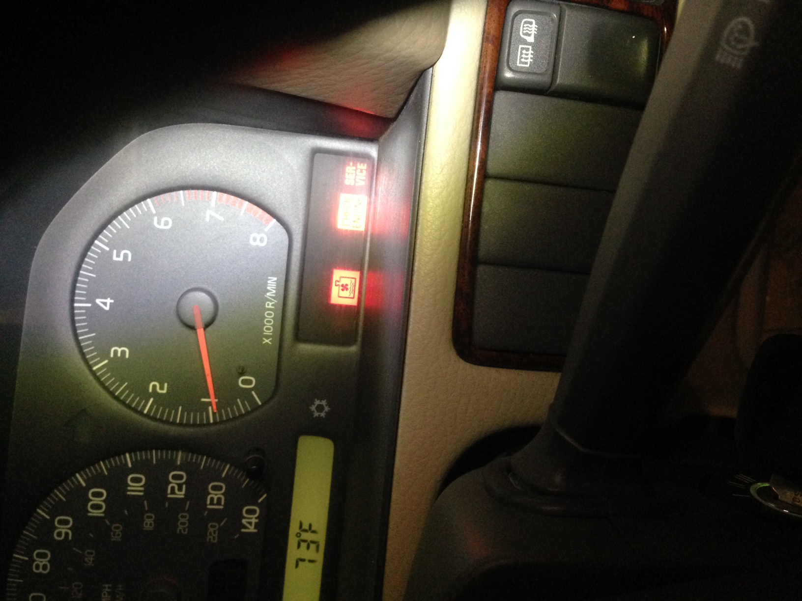

When I checked the instrument panel I had a new light that looked like the radiator. It's the light first from the left. Directly on the right of where the Flashing Arrow light goes. (See Picture)
Any ideas what that is? Why would someone solder it together? That is, what would it accomplish?
Thanks
Posts: 35272
Has thanked: 1497 times
Been thanked: 3810 times
That's your coolant level sensor. It's inductive and fits up into the coolant reservoir
It's the first line of defense from a. 2000 usd engine overhaul.
I would not drive until it is replaced
