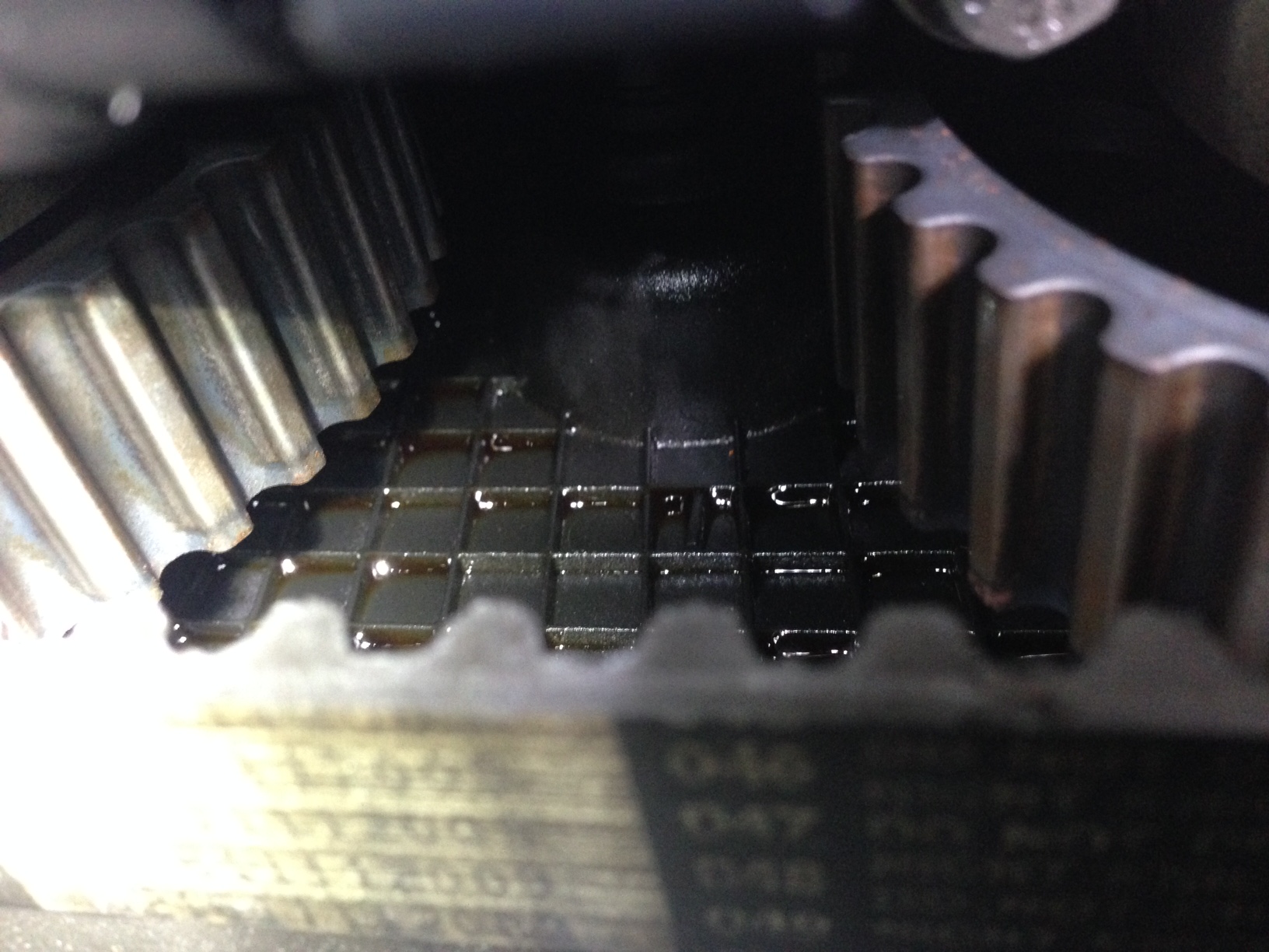

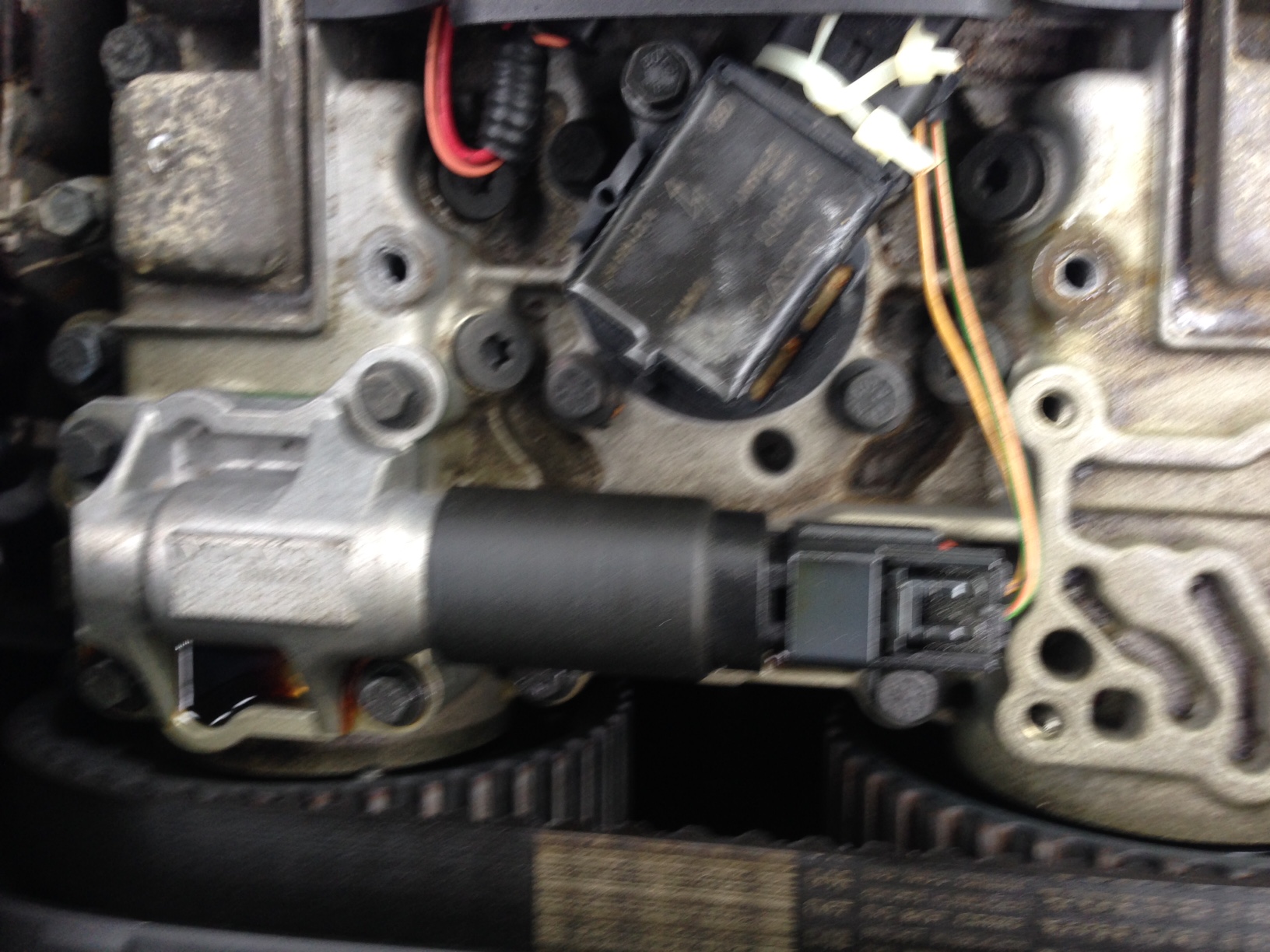

I pulled the timing cover and found evidence of oil. At this point I am not sure whether the cam seals or something else could be responsible for this. I have attached a photo that shows oil behind the cam pulleys. I am surprised that the belt doesn't appear to be saturated but there is definitely oil where it should not be. Not sure of my next step, I may try to run the engine and see if that helps me isolate this.

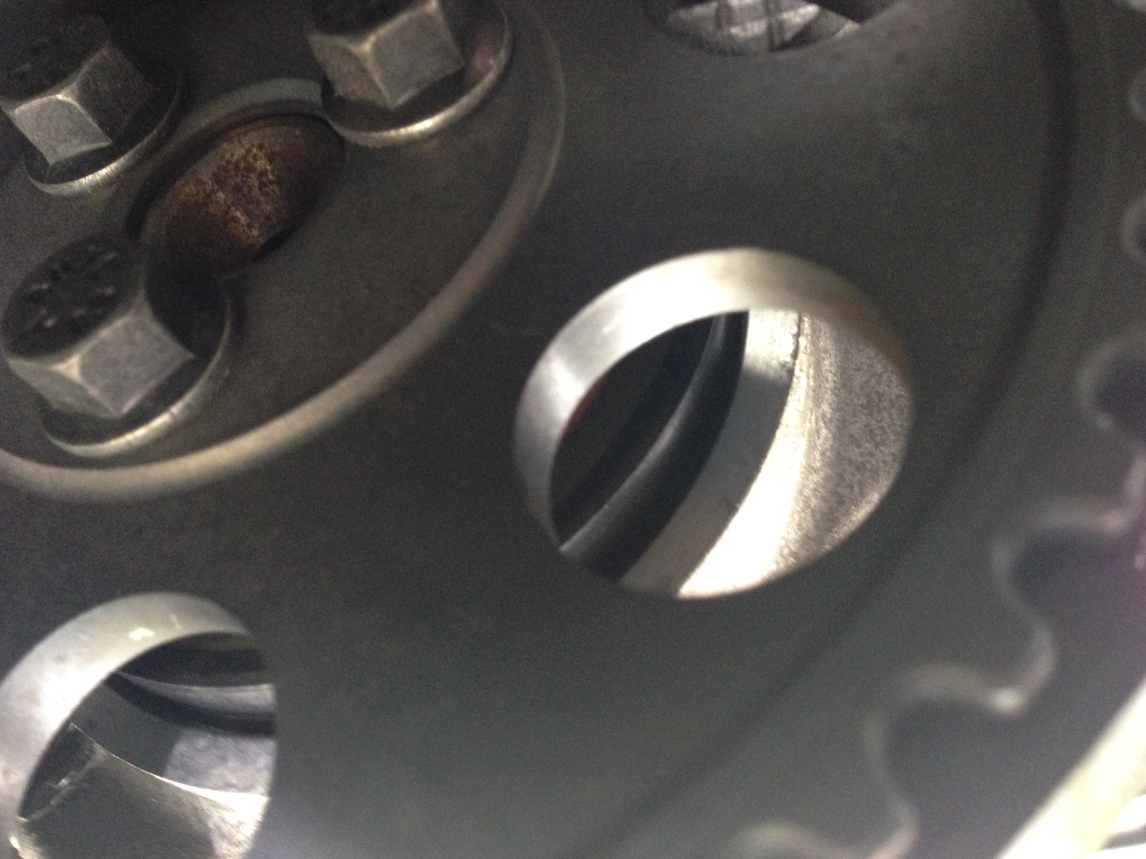

I believe that my diagnosis has been completed, with the issue being the front intake cam seal. The seal has dislodged itself and is no longer properly seated. Not sure why this would occur. The vehicle has 62k miles and the first timing belt was done at 40k (due to age).
Any suggestions for the easiest and quickest way to get that pulley out of the way to change the seal? Thoughts or concerns regarding the fact that this has occurred would be appreciated.
