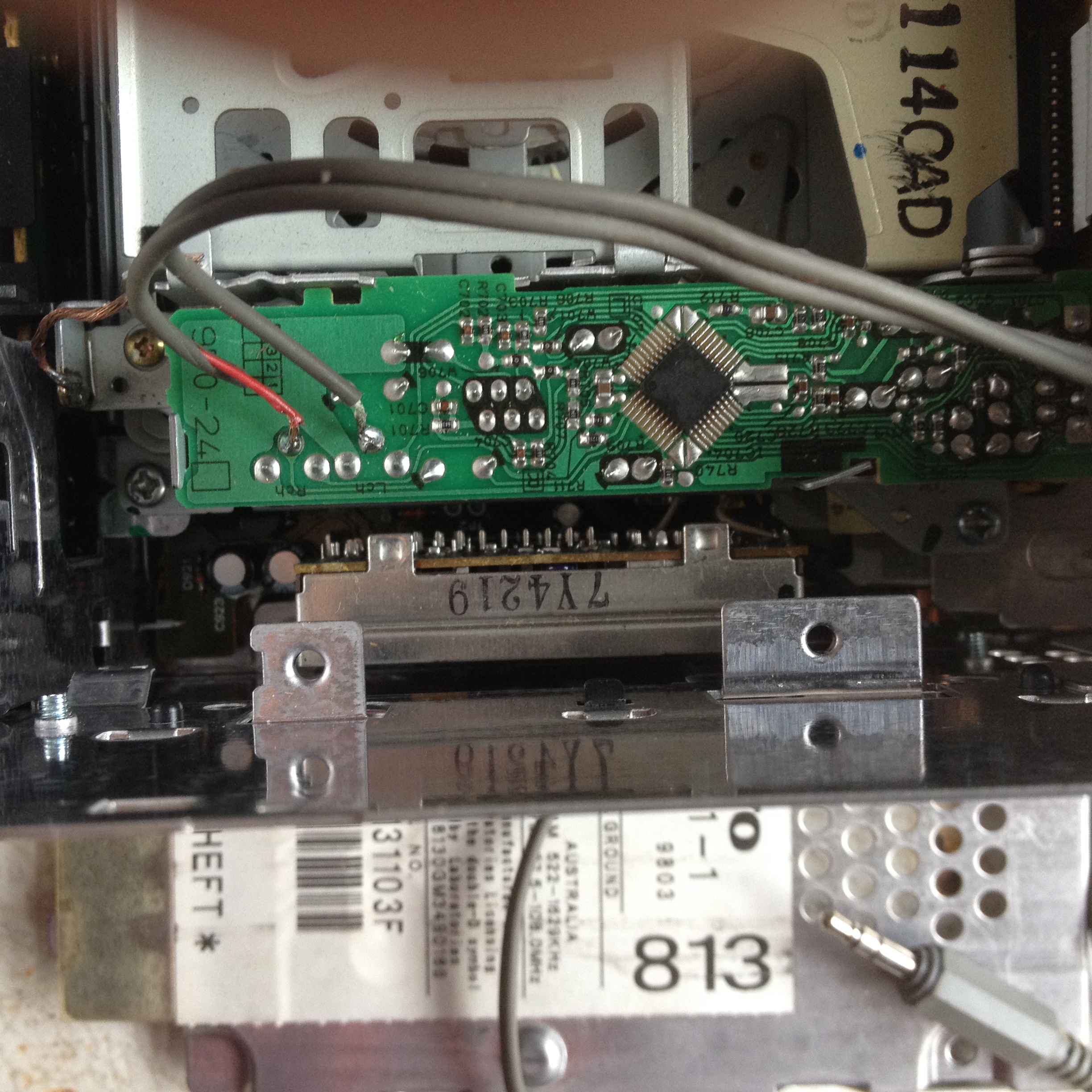

Could someone explain what point I should solder each wire to. It would be greatly appreciated.
Take a 3.5mm to red/white aux cable and cut It right at the RCA jacks. Solder the red RCA side to the Rch W pin in the picture and the white RCA side to the Lch W pin in the picture. twist the two bare copper wires together and solder them to either the Lch or Rch negative pin. Make sure that the negative wires touch NOTHING else. I put a bit of tape on the board after I soldered it and layed it on the tape. Its VERY important that the 3 wires touch NOTHING on the PCB.
I just found this thread, so sorry if this is too late for all of you looking to do this two or three years ago, but, for anyone else, here is my 813 head unit with the former headphone wires in place on the upper circuit board of the tape player. I soldered the ground directly to the tape player chassis. I've tested it using an old tape adapter that I stuck in the player to "fool" it and it sounds great. Thanks again to fazoo for the basic knowledge and great photos to get me started!

I still don't understand. If I only have two wires from my old pair of headphones, where is the third wire coming from to create a ground?
