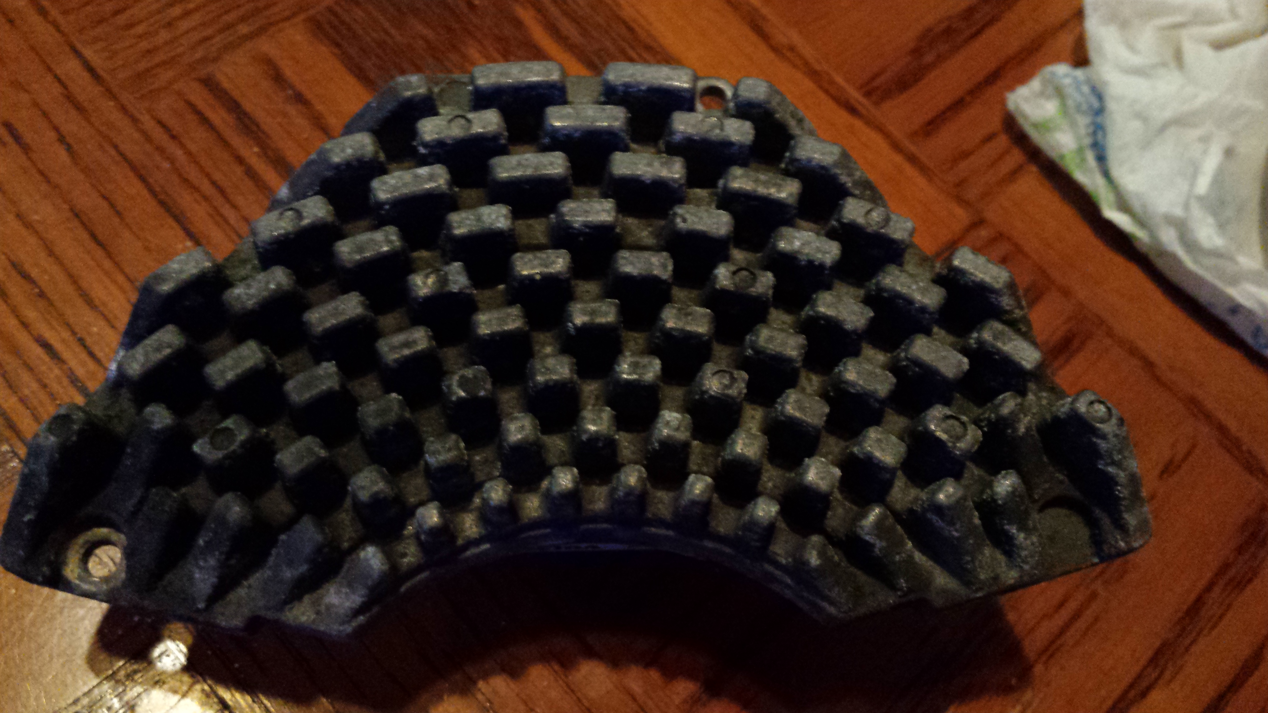

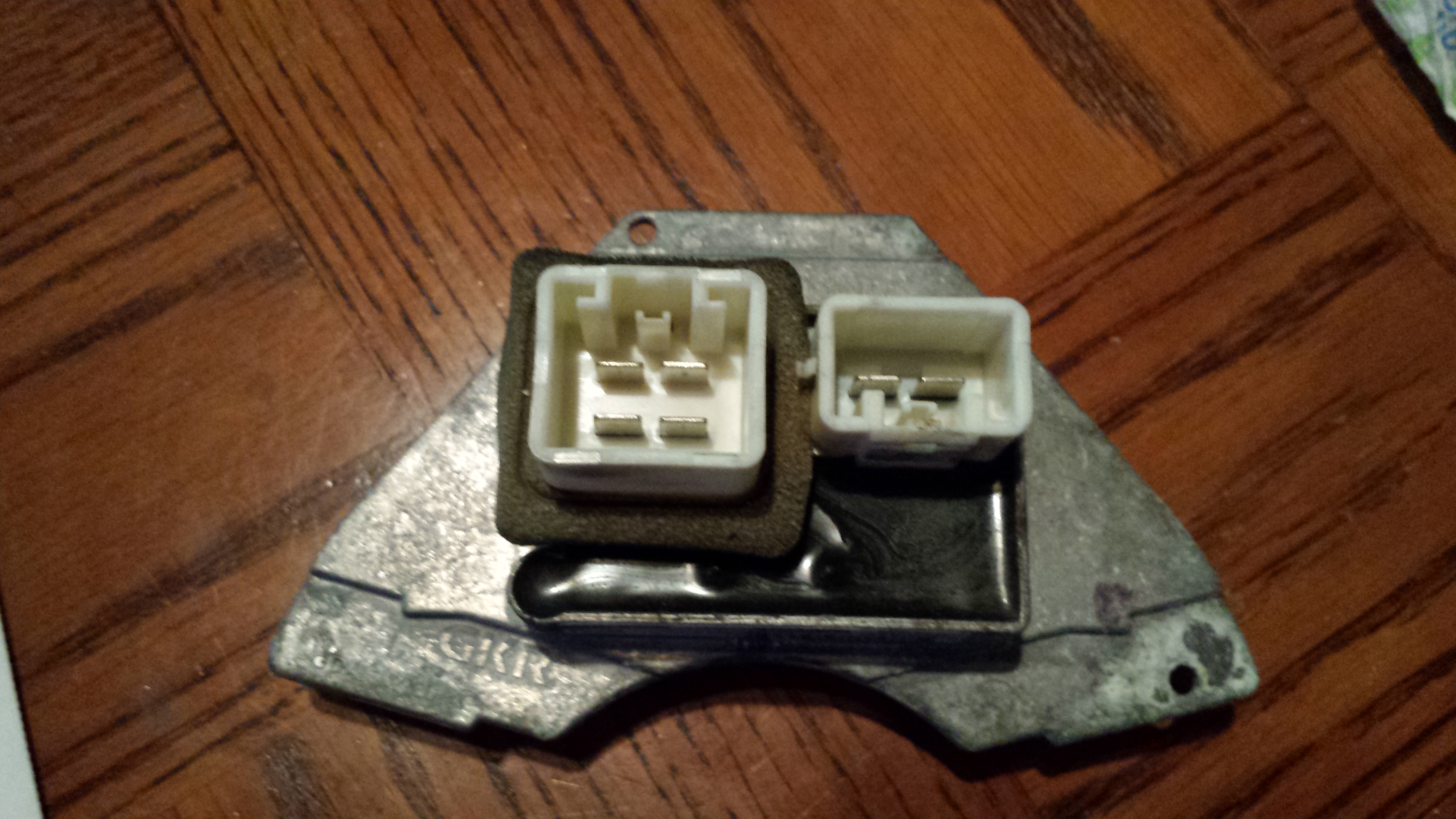

I did get the resistor out and the fan seems to turn without a problem. The resistor itself is very dirty and looks kind of like it's starting to corrode. I took a picture of it if that helps to determine if it's bad.

No reason to mull this over, just replace it, they go bad
